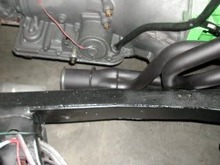

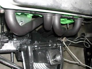

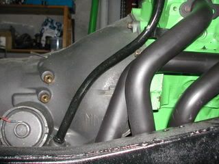

Think these will be OK . Not sure about clearing the firewall and are the passenger side too close to the tranny.
These are flowtech 1100's for early camaro's
[IMG]http://i126.photobucket.com/albums/p87/litemup79
if these don't work will try the early Novas 62 to 7

Dude, someone stole your cab :esurprised
They look OK but are they too low for clearance?

Nah i have around 4 inches but of course no front or cab yet, I can raise the truck uo with the coils.

What did you do about the stock motor mounts? Are they in the way?

They might not fit from the first pic. The firewall on both ny trucks come over the tranny bolts. Hope it fits!

I made new motor mounts as in the pics on the coil over post. the headers fit ove top the mounts

Yep tjose won't even come close on mine. The other ones sure look like they will work for my app. only not sure if they will fit between the tranny tab and frame. Alot of people grind off the tab on the 700r4 that the shiled fastens to.

I also found my block huggers hit my new motor mounts with the front tube.

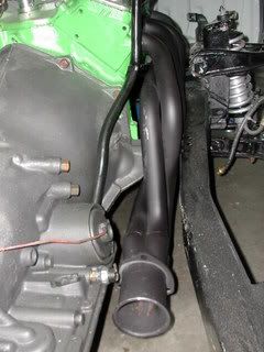

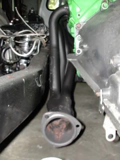

i will be selling my fender well headers if your interested , im gonna build me a new set of long tubes to go inside the frame , the only thing is you will lose a little turning radius but it was never a problem on my truck . ps try and post a pic with the full side veiw of the passenger side header cant relly tell from these pics if you have enough room to move the last two tubes or not

The 1100's will hit the were the firewall meets at the slope back area. My tranny dipstick actually sets against the firewall.
I tried 2 more sets of shorties last nite still no luck. probably have the guy on ebay in Arkansas build some unless i can get the muffler shop to do it. Is muffler pipe as good as regular header pipe.

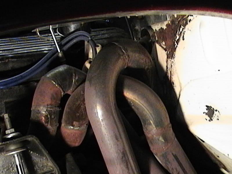

You mean like these? Why not weld clearance blisters in the firewall/floor board?

mine look nothing like those

Looks awful.

I know they don't look purty but when you can't find headers that fit you make your own and there are no headers to put a 455 Buick in a LUV so i built them but all i had was a wire feed welder and now i have a tig welder so the next ones will look a lot better.
As for the Chevy headers that are a close fit you can buy the tubing and rerout the tube or tubes to make them fit. Oh and has anybody tried fitting the tri-y type header?
