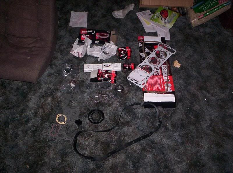

well, its time to get the thread going for the pup.
ive got the engine rebuilt kit now. its got everything.
im gonna start tearin into it next week and take the block and head to a machine shop to have the surfaces surfaced.
then im gonna send out one of my core cams to delta, and have them re-grind it to my specs. im gonna go with a 272/272 .425lift with a 110LSA.

the kit i bought was an autozone premium re-ring kit w/mains. it cost me $223 altogether.
