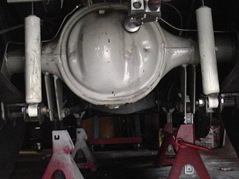

PostPosted: Sat Feb 17, 2007 7:04 pm
You can have you leaf springs and race it to.
