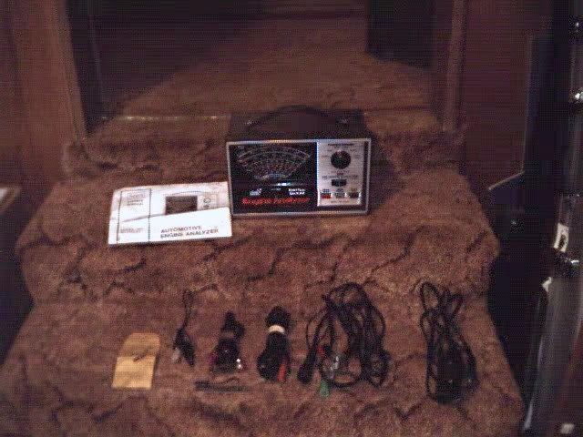

What you see is what I got.

This is the complete kit;
The far right cable is the lead for r.p.m. reading from a plug wire.
Next is the battery leads with the dwell wire
Then a ohms/resistance wire
The alternator/amp leads and a small jumper wire with some clips and connectors.
If you can locate the r.p.m. wire lead, you'll be good to go. The other stuff you dont have is almost useless on a modern vehicle. All that extra stuff i got stays in a plastic bag in the rear compartment of the analizer. I'll bet i haven't opened that bag in 20 years!

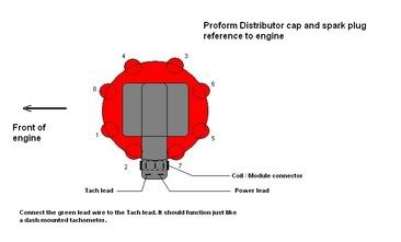

OK, you have the newer version. Connect the green alligator clip to the tach lead on the H.E.I. distributor.
When i still had the stock motor in my truck, i connected the green wire to the points lead on the distributor. I could set the dwell and get r.p.m. readings too.
Sorry i didn't think of that sooner. It's been too long since i had to deal with that particular wire lead.

With H.E.I., you dont need to think of having a points lead but a stock LUV motor you do. The green lead connects on to the tach connection on the distributor cap. You'll most likely need to make a jumper wire to connect to the tach lead. You might be able to attach the alligator clip directly to the tach lead but it would be safer not to dog up anything on the distributor cap.
