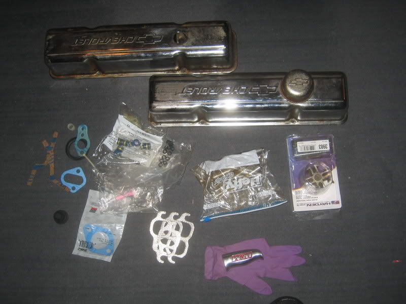

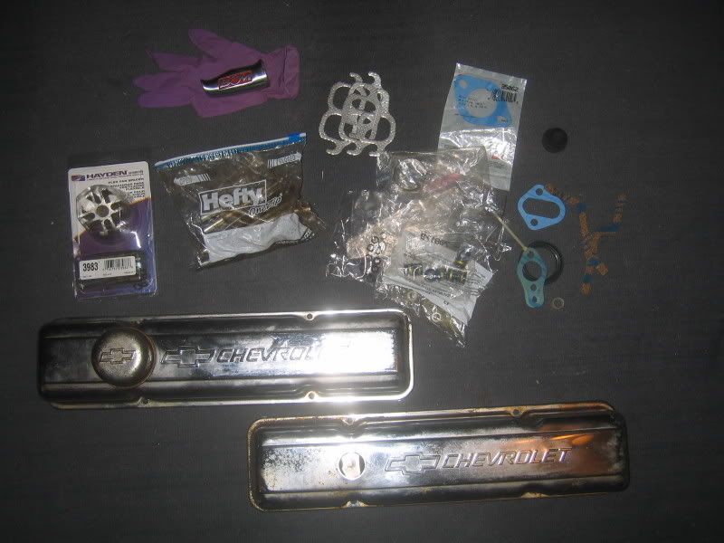

Hotrod80 sent me a set of valve covers, and some other really cool stuff. Gratis. He wouldn't even tell me shipping costs. This board rocks 8) .
Here is what he included:
Image Image
-Chrome heavy gauge Chevrolet logo valve covers, breather cap
-T-handle valve cover hold downs
-Dozen or so misc. Gaskets
-Nylon valve stem seals
-Fan spacer
-REALLY nice B&M aluminum shifter handle
-and a couple of un-identifiables to my novice SBC mind...lol
Thank you Hotrod80.

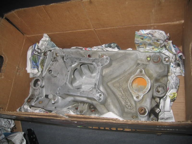

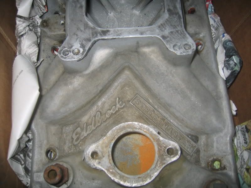

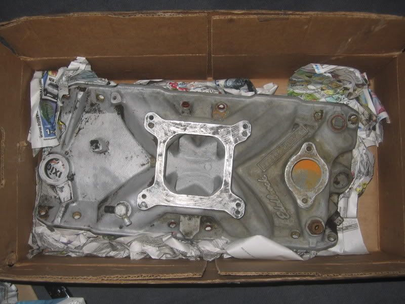

My Edelbrock Streetmaster intake arrived from Ebay, it's a single plane but I think it's going to be alright. In really good shape. $56 including shipping...

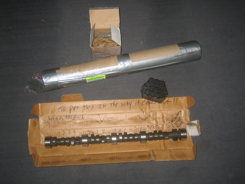

My cam and lifters also arrived, but there is a BIG problem. The numbers written on the lifters have mostly rubbed off. I'm not sure what I'm going to do about this. $35 including shipping.
The seller was really good about numbering this stuff so it could be put back together right...Help!?

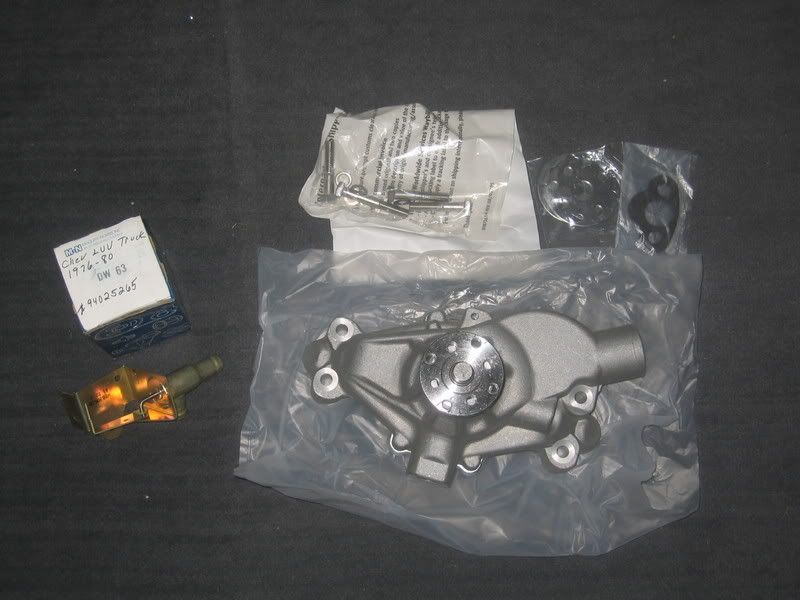

I sold the Weber, so I went ahead and ordered this:
http://cgi.ebay.com/ebaymotors/ws/eBayI ... :IT&ih=017
How am I going to hook up heater hoses with this water pump?

The seller of my cam emailed me that the cam only has 1.5 hours on it. He suggested I just drop the lifters anywhere. I just don't know enough about the break in time to know if I should risk it...

There are 2 brass plugs in the pump. Leave the one on the top plugged. One hose nipple will go in the other plugged spot, and the other hose will either go in the intake, or the radiator if it has a provision.

what is the disadvantage/advantage to using the water hole on the SIDE of the pump instead of the one on the TOP?

The top one was used for a short hose to the intake similar to the way a BBC is. The one on the side I suggested as that's the way most sbc's are run and it just looks a little cleaner on the installation, IMO. There is no advantage as far as I know.

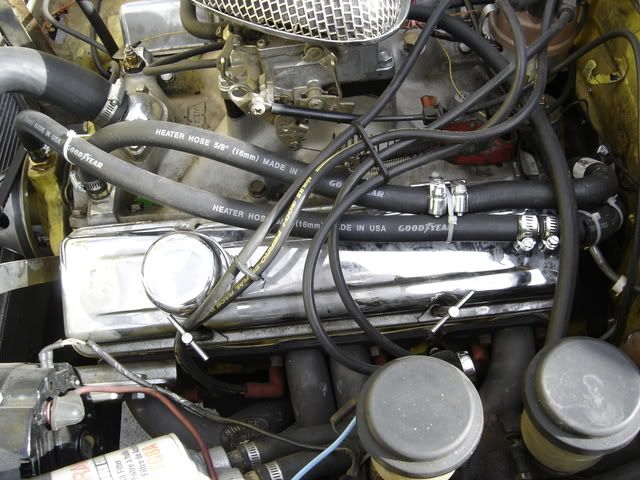

chevyluvss, got any pics of your engine? I'm using the photos hotrod80 posted early in this thread as a guide to how it's supposed to go together, but I'm curious how this hose setup differs from his.

I dont have any recent ones, but i keep her at my shop, i'll take some in the morning and post them tomorrow for ya!

sorry bout the wait, AND THE MESSY ENGINE BAY, hope this is what you had in mind.
works great and heats up super fast, the only thing i am unsure of is where i have the temp sensor (its on the intake). I would have liked to pluged it into the head but they are early vette head and do not have that provision. :( bummer huh

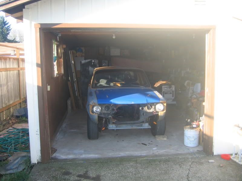

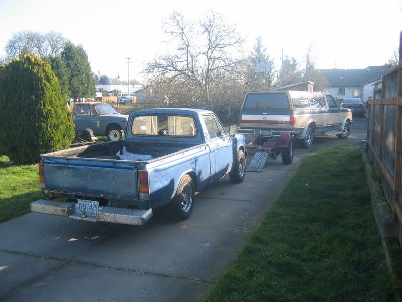

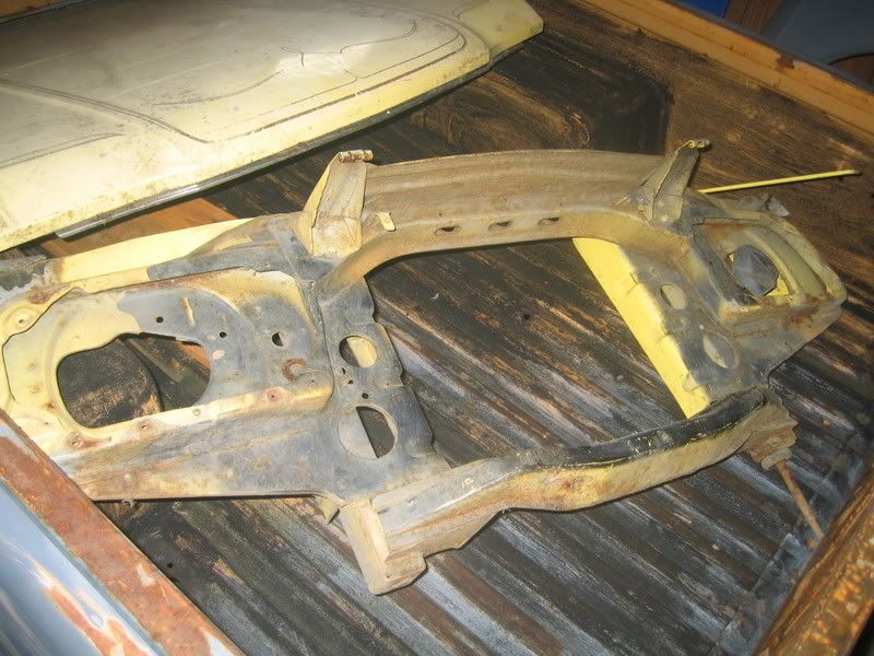

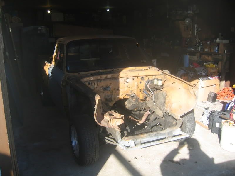

I'm pretty excited about this newest development. One more opportunity to pay it forward. I gave luvprojects the '78, and I now have the '75 in the garage! Woohoo!
James (luvprojects) brought up a core support and a really nice hood, so it was sort of a trade, but the '78 is now his. Not sure what his plans are, but I'm glad to see it go to another member here, and it's one less thing in the way for the V8 project.
The '78 is no prize, but then again it's more complete than the '75 is, and free is free... 8)
Here's some pics...
Bye-bye '78. We pulled the back bumper after we moved it onto the trailer, it only had about 3" of road clearance....
Hello covered work area! Yay! The '75 is FINALLY inside...
Hoping to begin work on the engine dissassembly and cleaning up the wiring and core support. More to come as I can begin to actually quit talking about this and start doing it. :D

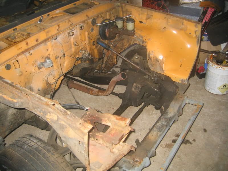

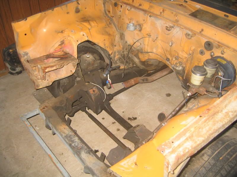

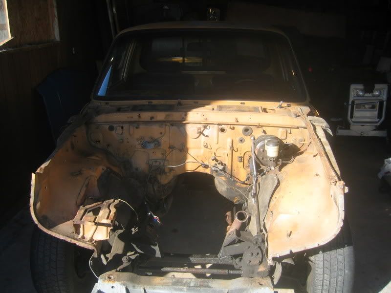

Got the core support out. I don't have a torch, so I had to make do. Wonderbar and a hammer, yay.
Pulled the wiring, and began a little clean up. The passenger inner fender is bent pretty good, the plan is to put the new core support in after the engine/trans goes in, so I'll have some time to figure out how to get it straight.
Man, there is A LOT of work ahead of me...lol... :lol: :crazyeyes: :scrambleup:

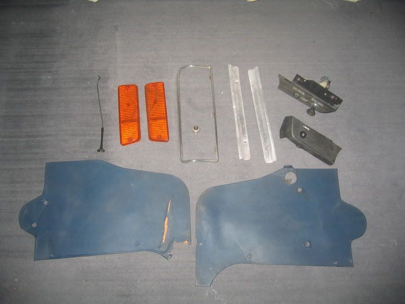

More parts, I'm hoping to pick up an engine lift tomorrow and finally get my engine set up on the stand. Depends on the weather, but we'll see...
New parts:
Alumimun hi-flow water pump
OEM NOS heater control valve
Used parts:
Mikado kick panels (rondog)
Luv cigarette lighter
Front bumper turn signal lenses
door sill plates
Drivers rear tailight chrome bezel
vent pull knob
windshield wiper switch
windshield wiper swith housing (Wolfsburg)

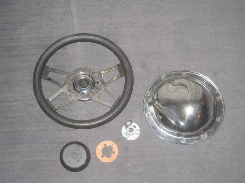

Chevy 10 Bolt chrom diff cover
Grant GT Steering wheel w/adapter (TPI Guy)
Anyone need the diff cover? Pay shipping and I'll get it out to you. Just PM me, please.
I may have an aftermarket steering wheel and adapter available soon. I bought the one WildLuvRacing1974 had for sale and a few days later TPI Guy gave me this one. :)
I bought the kick panels from rondog with the specific intention of using them for templates and possibly making a pattern and/or pre-cut piece available here. Any interest in this?
