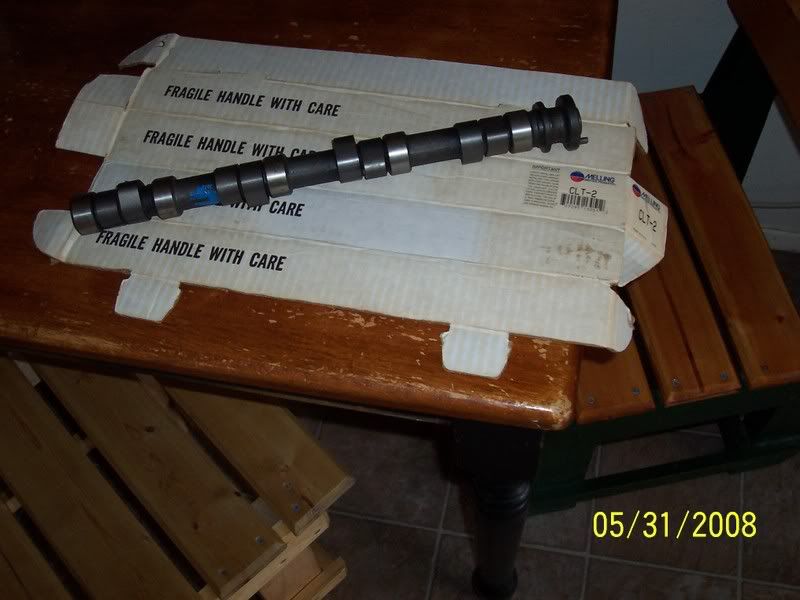

Cams are really interesting. That's camshaft spelled correctly. The one Catman referred to earlier is a modified cam, I think. It wouldn't be any larger than a stock cam, but the lobes have been re-ground to open/close the valves earlier/later. The result is enhanced performance. It's a good thing. I know we all want our LUVs to do exactly what we tell them to do, and it is in us all that when something isn't right with our ride we want it fixed. Some of us don't take that step to better performance and thus never know the joy and ectasy of the better ride. I don't know what everyone on LT.com has for a LUV, (or a UTE), but I know a few of us. Regardless, it should be well-established here that the LUV truck, the chassis and the engine, are a do-it-yourselfer's dream, and a right sturdy one. Modifications done correctly to the truck yield great results, and that is largely the reason we're all here. For the love of a LUV.
I've got a new stock cam here in the box that I got off ebay. You know the pin in the cam? The one that goes in to the timing chain sprocket? Mine slipped out a couple times and into the sprocket. The engine stops immediately. The first time, I put the pin back while the camshaft was still installed in the engine. When that failed very shortly, I removed the camshaft and used a vise to hold it while I replaced the pin in tight. It's still working just fine. I didn't install my new cam. I talked with the machine shop awhile back and they advised me there was a concern with the mating surfaces between the camshaft lobes and the rocker arms. One used surface would not mate correctly with a new surface. Meaning that if the new cam was going to be installed it should be milled/prepped for the existing rocker arms, so that they will mate surfaces, and not cause premature failure. The machine shop, (Pacific Auto in Renton, right off Hwy. 405 and Maple Valley exit), advised me that ignoring this preparation would precipitate failure at an astonishing rate. I also acquired a special lubricant that should be applied to the lobes when this procedure has been followed, which would aid the mating of the surfaces. I don't know when I will put the new cam in, but getting the modifications done to the camshaft is an intriguing thought. We're talking about thousandths of an inch here, opening and closing of the intake and exhaust valves at varying degrees of rotation. Yes, I know it makes your head spin. If you have the mathematical skills maybe you could explain it, but the end result is enhanced performance. I know I've said I like to get from A to B, but it's even better to arrive safe and happy when the ride was fun. May we all do so.

A cam can be custom-designed By Delta Cams to match whatever you want it to accomplish for your engine. There are a lot of variables involved in choosing exactly what lift and what duration will work for your needs. I'll just leave that to them - they are the experts. So if you wanna know about Cams, I'd highly recommend you giving them a call (use their toll-free number if necessary), and talk to them. They are nice folks and I'm sure they will have no problem answering any/all questions you might have.
As for puting a new cam in a used head - you should have a manual around handy so that you can make sure that your head, rocker arm assembly, etc. is still in decent enough shape to install the cam into it. I personally always check the spec's, inspect everything for allowable tolerances, and visually inspect everything else before I install a new cam. Also, I always use plenty of good quality cam assembly/installation lube, and re-adjust my valve clearances before I start my engine up. Then I turn my idle up high and let the truck run for about 20 minutes or so to break in the cam. Then after a few days of light driving, I check my valve clearances again, adjust them again if necessary, and change my oil and filter.
As for the pin that aligns the cam with the gear - I've seen first hand what happens when the pin snaps or comes out and the cam stops spinning while the engine is still running, and it aint pretty. Unless of course you really enjoy looking at holes in piston tops, and all-bent-to-hell valves....lol
So obviously you want the pin in there snugly, and you want to make damn sure you tighten the gear down on the end of the cam to the proper torque specs. The manual explains that all in detail, and the guys at Delta Cam will install a freh pin in your new cam and make sure it is in their snug. So if you get a cam done by them, I personally wouldn't worry too much about it.
So far, I've never had one fail or had any other problems with one yet. And Idoubt if lasthas much to dowith that. If I was lucky, would I have been born this ugly and poor?
