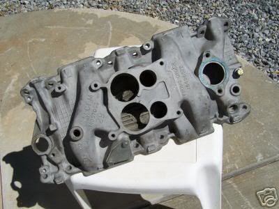

I'm looking at the '80-86 305/350 Chevy aluminum manifold. 14057053.
What is this bore design called? Comments appreciated. :)
PostPosted: Thu Oct 25, 2007 7:03 pm
It's called a sreadbore and you will be better off with a performer manifold as a lot of the 80-86 Alum. manifolds are cracked or are going to.
This causes a vac. leak that can melt a piston before you realize it.

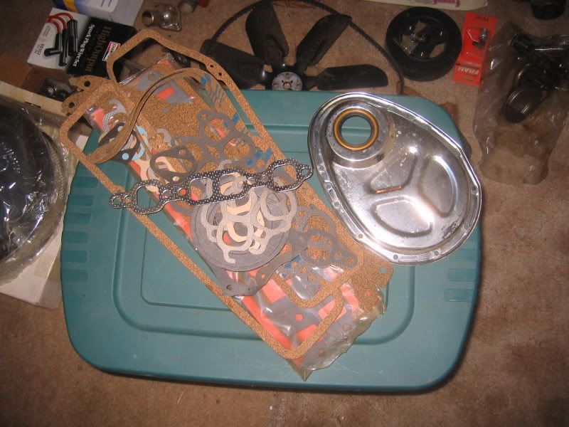

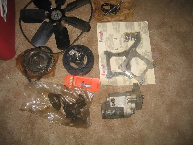

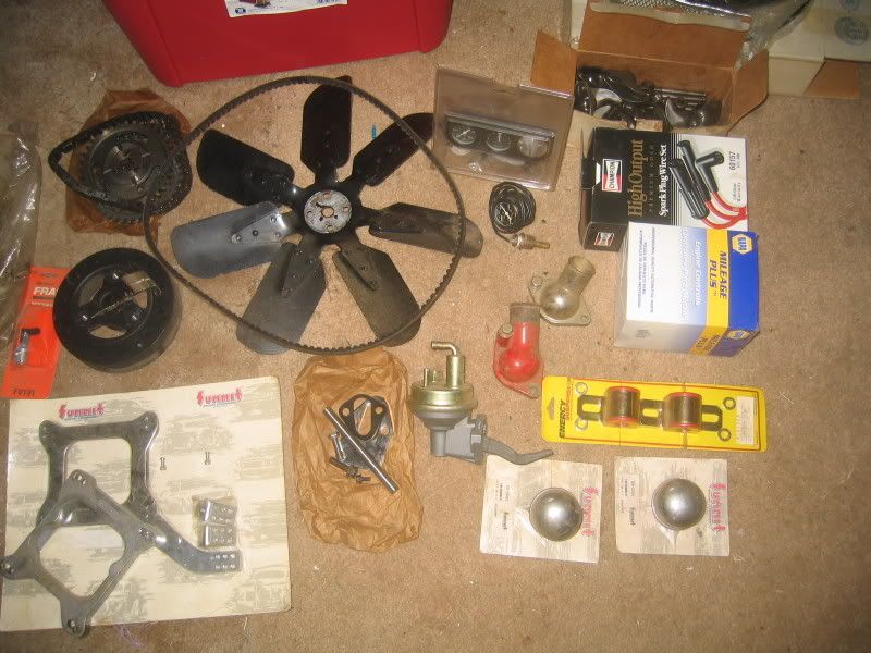

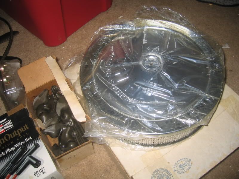

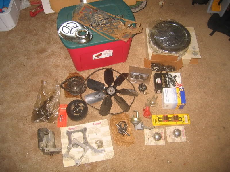

Holy smokes was I suprised when I opened this thing up. I was stunned at what he called 'trash'... I'm going to try to convince him to take some money for this stuff, but as it stands this is one more free acquisition for this project. Take a gander :)
Image Image
Image Image
Here's the inventory list:
-Mini starter
-New double roller timing set, w/2 chains
-Oil pump
-Rocker arms, pushrods
-Fan
-Oil breathers (still in blister pak)
-Air filter (brand new Summit, still in box)
-Motor mounts (still in blister pak)
-Chrome timing chain cover
-Lots of new gaskets
-New damper and timing pointer
-set of 3 mini-gauges (still in blister pak)
-2 carb adapters (one still in blister pak)
-New mechanical fuel pump
-2 filler necks
-New spark plug wires
-New dizzy cap
-New PCV valve
-Box of new plugs
-A new parts tub *grin*
Wow! I figure there is a couple hundred dollars worth of stuff here, easy...
Life is good 8)
PostPosted: Sun Oct 28, 2007 8:12 pm
nice score!:lol:
PostPosted: Sun Oct 28, 2007 8:13 pm
Cool deal! Now do yourself a favor and lose the chrome timing cover. Those things are notorious for leaking...

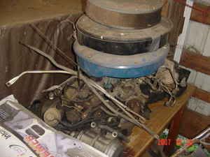

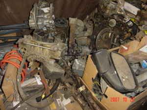

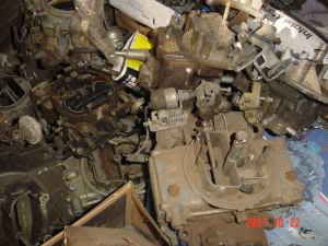

I have no idea what all is here, this is one of those friend-of-a-friend things where the guy's son sent me some pics off his phone...
The kid said $100 for all of this stuff, but the dad (who it belongs to) was a bit quiet when the price came up. Anyway, I figure there is a core here that would work for me, so I'd appreciate it if you guys could tell me what you can make out here. I think I see a Holley 4160 and either an AFB or a Q-jet, but I just don't know. The intake in the one pic is also for sale, it looks like a dual plane. This stuff is nearby, so I should probably just go take a look...
Image Image
I know the pics are small, thanks for looking.
PostPosted: Mon Oct 29, 2007 8:29 pm
I like the 500 to 600 cfm holleys with the vacuum secondaries on near stockers, along with a good dual plane intake.
PostPosted: Tue Oct 30, 2007 4:23 am
Posts: 1075
Location: porterville,cali
theres a holly heres a holly wouldn't you like to buy a holly to lol
(dr pepper)
dangerous-toys4life
75 k-5 2x
94 king cab
PostPosted: Tue Oct 30, 2007 10:36 am
I see 2 holleys in the pics so 100.00 bucks would be a good deal then sort the rest and sell it and the holleys may be free then.

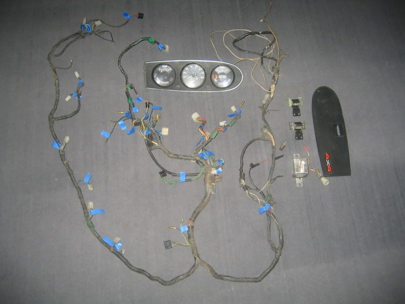

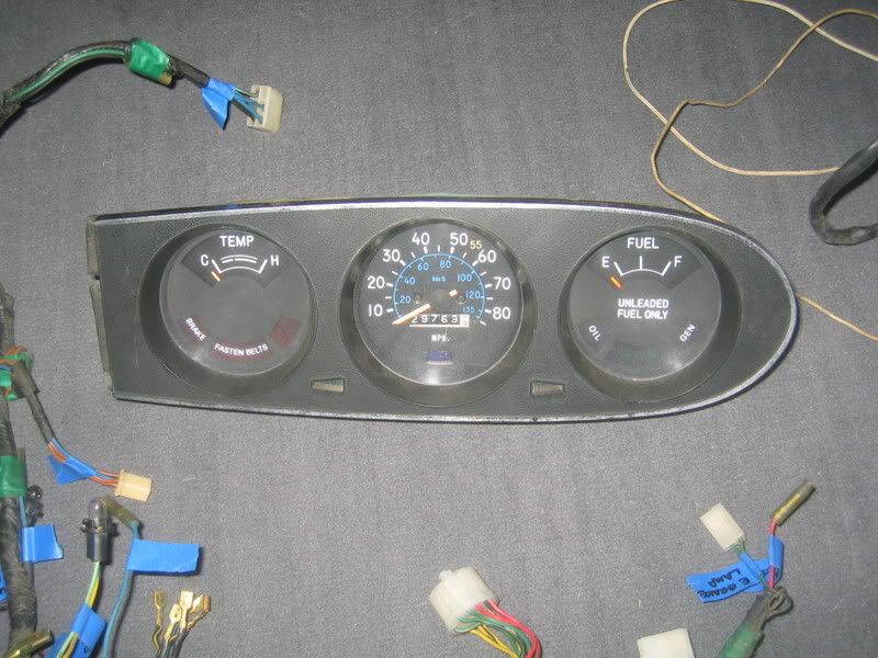

Got a box of parts from Aaron516 yesterday. This is officially the first parts purchase for the '75. Aaron was great to deal with, sent what I paid for, and kept in touch through PM's. Pulling the harness was probably a pain in the arse, but he did it without destroying it and gave me a fair price for the whole shootin' works. Thanks Aaron 8)
I don't have all the tags on in this photo, but you get the idea. I wiped it down and completely wrang it out with a multimeter. It's about perfect :D. I could not figure out one connector, turns out it was the FACTORY radio plug. No wonder, I've never actually seen one...hahaha...
This is the complete order: Wiring harness, Gauges, Glove Box door w/hinges, and a Voltage Regulator.
Here's the gauge panel, it's from a '80 4x4 and in really great shape.
This harness pretty much cinches my decision to go with a single headlight setup. The dash pod in the truck now has had wires directly soldered to the gauge pod posts. I'm not sure I'll be able to save it, but if I can, it will be up for grabs.

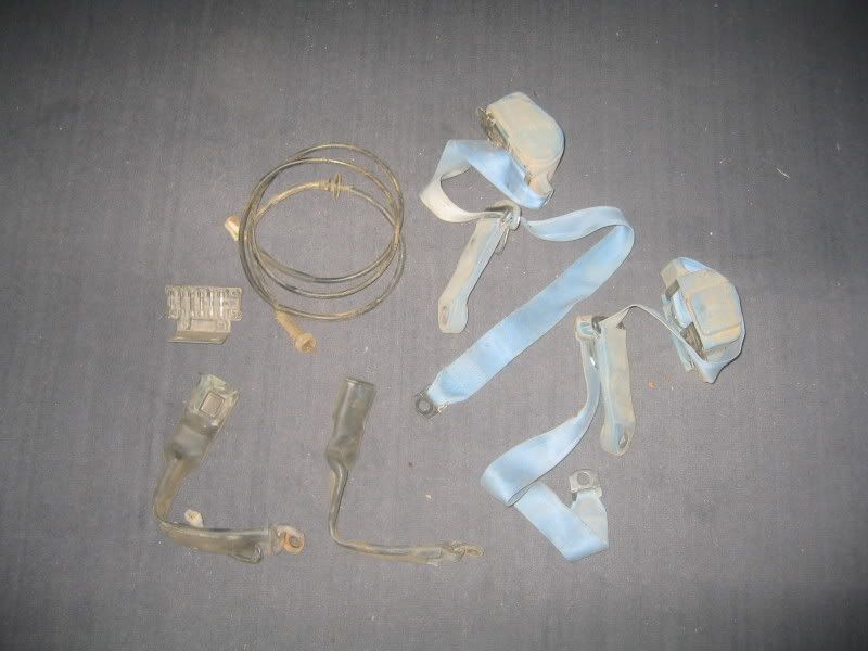

More parts, all the way from Kansas, courtesy of hotrodjd3.... :D
1. Fuse Panel (to go with my 'new' harness)
2. Speedo Cable
3. Pair of seatbelts w/receivers
I know it's boring, but I get all silly when I get new stuff for the project :roll: :wink:
