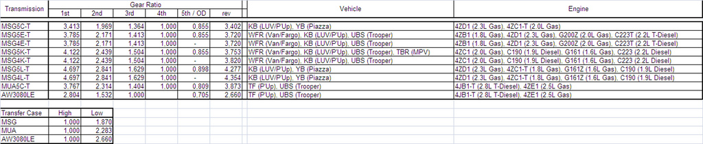

There needs to be some clarification of the tranny gear ratios listed in the above chart: the gear ratios listed as "gas" must be for a 2wd tranny, they are close to a Chevy LUV 2wd 4sp. The ratios for both the 4sp and 5sp gas 4x4 trannies match closely that of the listing for the "turbo dsl"- 4wd gas trannies had lower 1st-3rd gearing than 2wd.
These ratios were taken directly from various LUV/Trooper FSMs.

86/87 are the only years you will find a MSG 4wd 5sp that is a clone of your MSG 4wd 4sp, "just longer for the 5th gear".
88 they change tranys its a much stronger trans with HYD cluch, and has the 20% O\D :lol: :lol:
and then theres this list i forgot about. :lol: maybe the two charts to gether will make more since :?:
(some of these gear sets never came stat side) clicky on it to make bigger.
86trooperT/D 2.2
84 L\B 4x4Diesel LS 2.2
86 L\B 4X4 gas 5 speed 2.3
