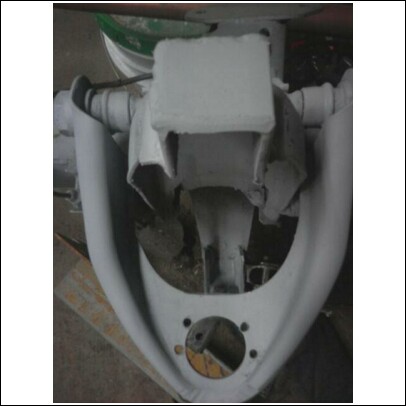

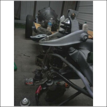

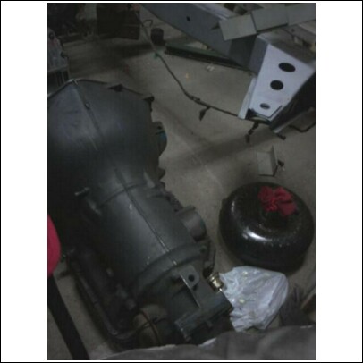

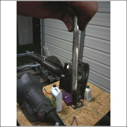

mountin the coilovers and ball joints for s10 conversion also got me a built th350 and 3200 stall for the 6.0l

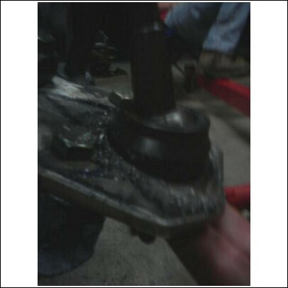

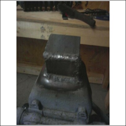

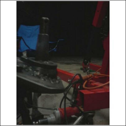

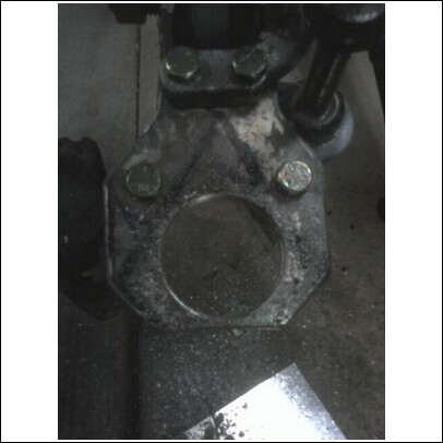

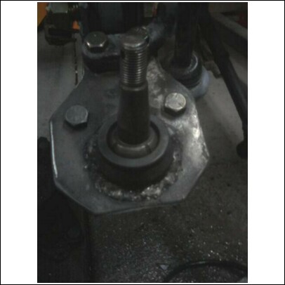

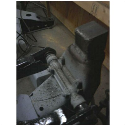

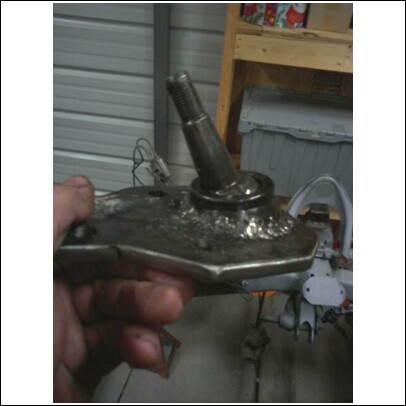

more pics of bottom plate design with s10 ball joint welded in. used 2 1/4 holesaw and pitched the ball joint at angle similiar to factory luv lower ball joint. bolted in top ball joint and tacked for security.

and more

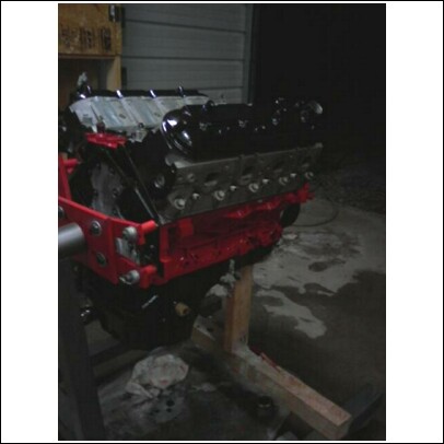

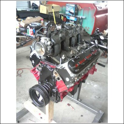

POR-15 is probably the coolest paint ive ever used it looks like powdercoat when our done.....i did my 6.0l ls1 chevrolet red to match all my msd stuff and other parts black also did some on the front part of my frame looks awesome.

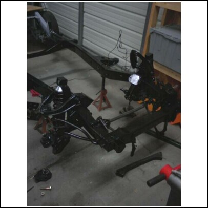

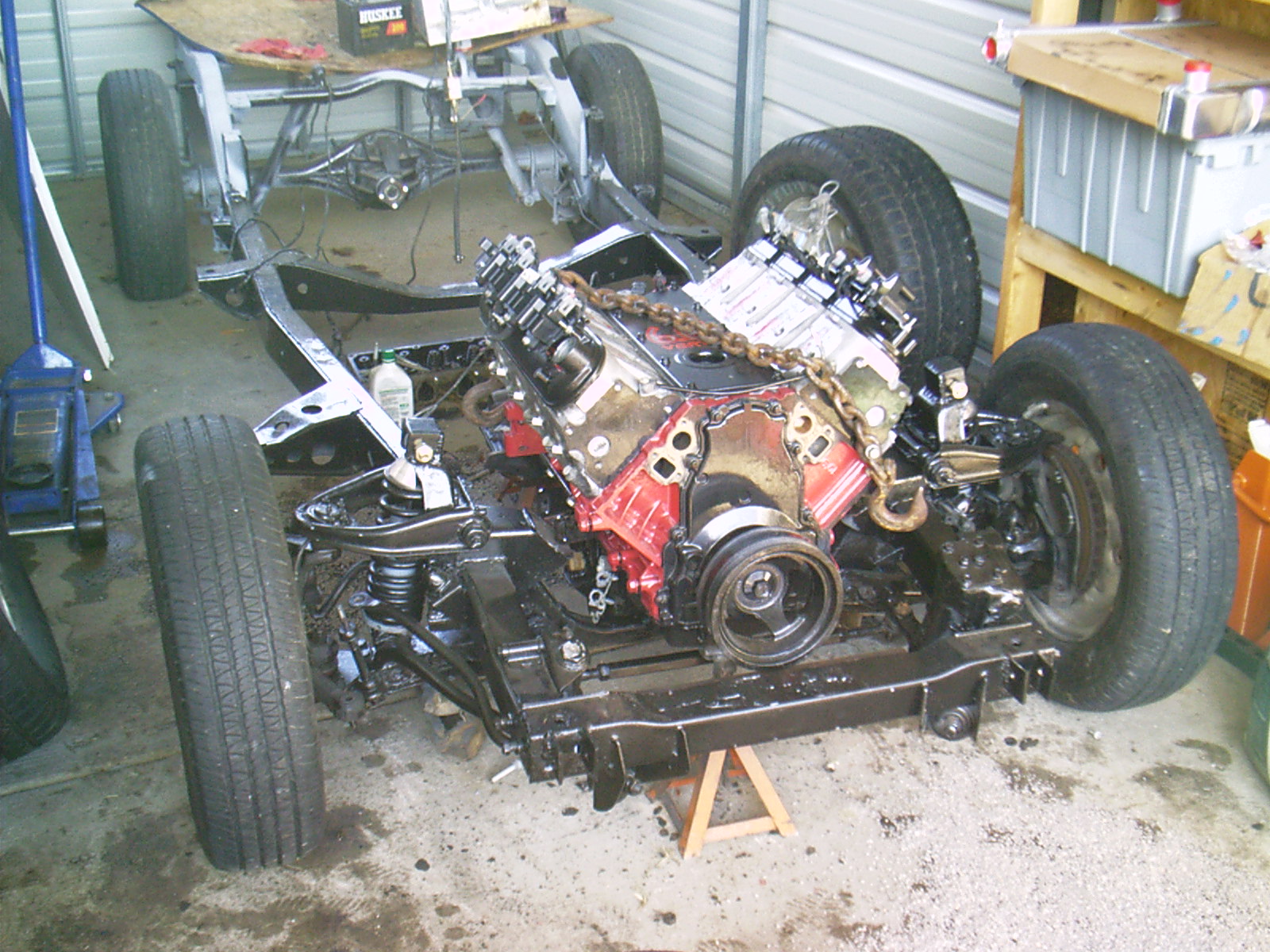

more stuff done painting motor. still waiting on intake and spindles/rotors/rearend. i got a new radiator 19x22 off ebay $150 great price and picked up some weld draglights with tires for a awesome price of $280 +30 bucks of polishing supplies!lol
6.0l ls1 swap th350

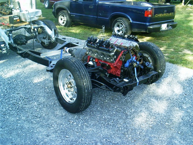

PostPosted: Fri Sep 26, 2008 3:08 pm
Posts: 259
Location: Murfreesboro, TN

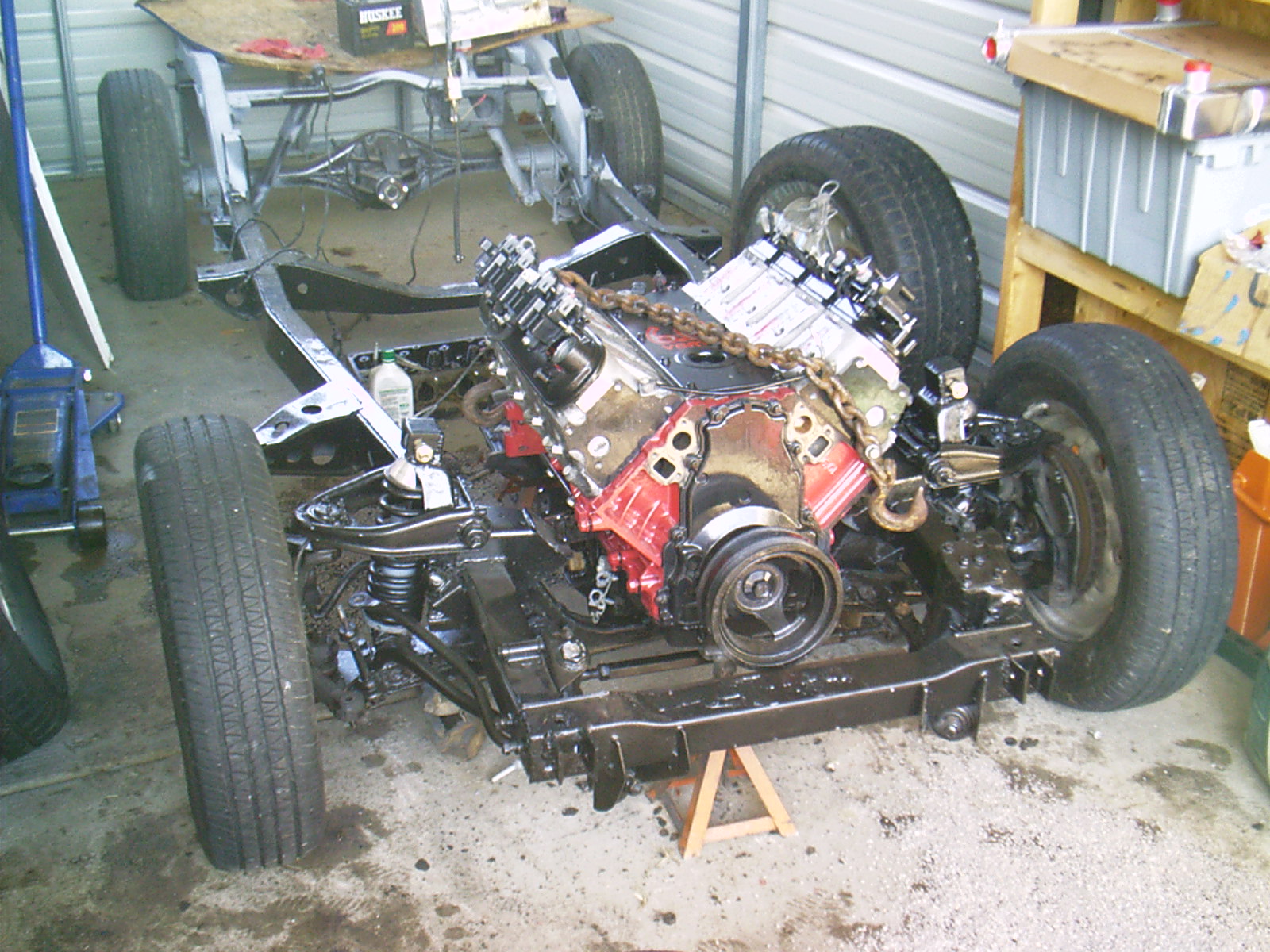

new updates i have decided to run fuel injection and turbo instead of carb and nitrous!lol finally got my spindles yesterday from guy and what do you know all my measurements worked spindles bolted up like factory! just have to figure out tierods now. motor is just sitting on frame now testing coilovers gonna make mounts when i find out the pinion angle im suppose to have.

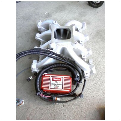

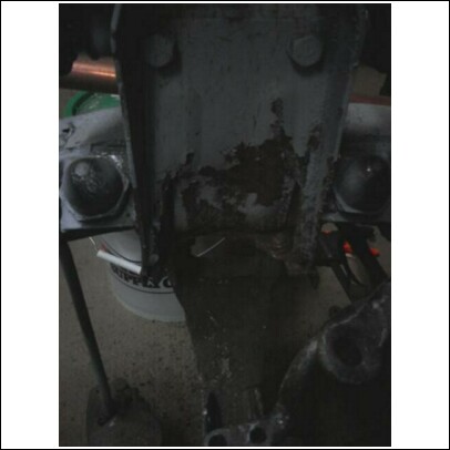

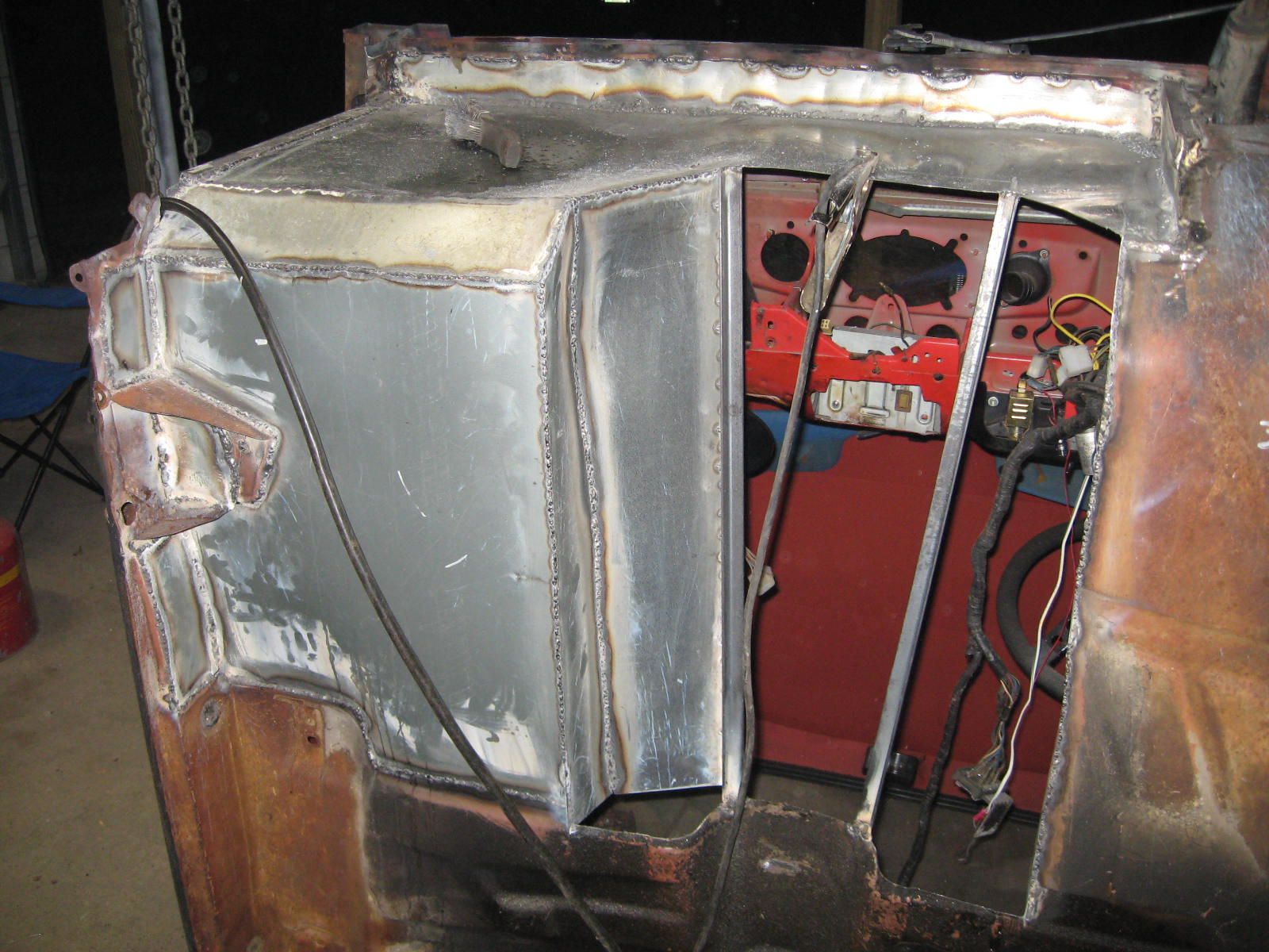

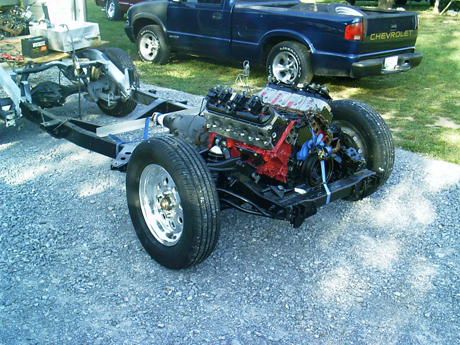

yea srry :roll: im runnin carb again got a victor jr carb intake and a holley 750 built by carb shop. i have been workin on my cab it was rusted very bad no floor in the passenger side. i moved my firewall back 2 1/2 inches and made my own trans tunnel also made my own crossmember for the tranny since i cut torsion bars out along with the factory crossmember. here is some pics. goin to get custom headers made in about a month by a buddy of mine also roll cage probably! i have also bought many parts for my motor xr-288 cam beehive springs gm racing lifters comp cams push rods etc and spacer to hook th350 to my motor!

are you redoing the firewall due too the motors location? can you take a pic of where the motor mounts are located, i want to compare them to the hooker location on my gen1 ,motor mounts are.
PostPosted: Tue Nov 11, 2008 2:38 pm
Posts: 259
well it was right on the firewall and no room for radiator clearance plus i wanted a smooth firewall and easy access to the tranny.
