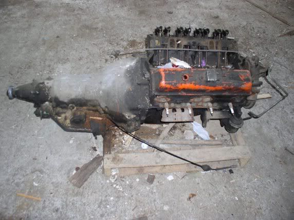

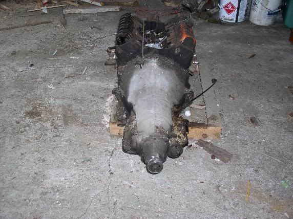

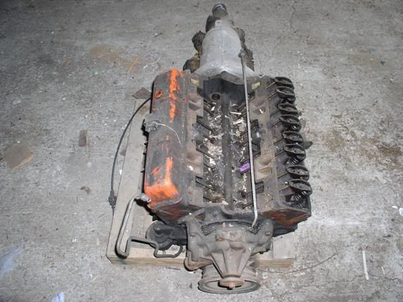

What is it? Sorry for the small photo size..
Image Image
Image Image

by the looks of it looks like a v8 :lol: lol
can you get the #off the block and some bigger pics

It certainly looks like a SBC. I think the trans is a short-shaft TH350 too, but I don't actually know what a TH400 looks like. I asked the guy to check on numbers for me. He's totally not a car guy, this was in his garage when he bought his house. I asked him to look at the head w/no cover, should be numbers right there, right? Can you see the block number on the back with the tranny mounted? Man, it's been a long time since I messed with this stuff... :D
PostPosted: Thu Oct 11, 2007 3:14 am
sbc & short tail th-350 . block #'s on driverside between bell housing and head .
PostPosted: Thu Oct 11, 2007 6:49 am
Posts: 590
Location: Spokane,Wa.
Hotrod80 is correct.
Th400 has a square tranny pan.
Th350 has square tranny pan with one corner lobbed off,so to speak.

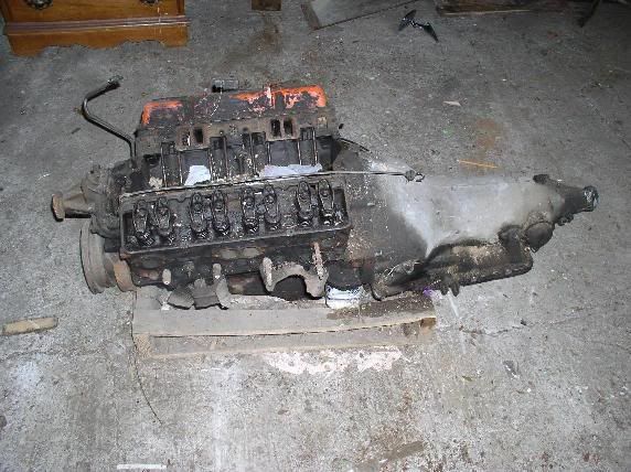

Got some numbers off the small block pictures I posted earlier, Mortec matches these up to a 350...
3970010 (block) - '69 327 / '69-80 350 (2 or 4 bolt)
333882 (heads) - '74-80 76cc (1.94/1.50)
Nothing stellar, and it will probably need a rebuild, but I'm excited anyway. If anyone knows anything 'special' about this combo, please let me know. If it stinks, I'd like to know that too...
I haven't seen it yet, but I'd guess it's probably a 2 bolt main with smog heads. I'll get better pictures next week.
Looks like I've got my engine and trans :)
