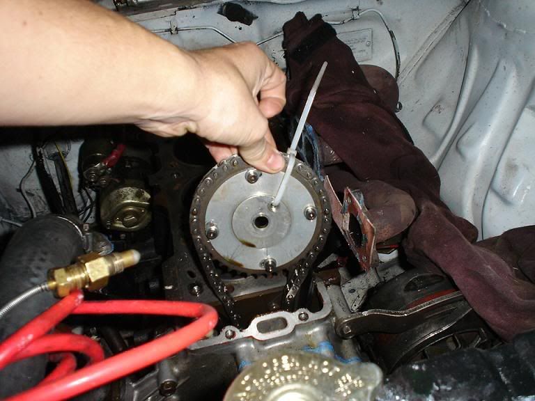

well i have the cam lined up now.
im buying a cam, AND an adjustable cam gear from a guy on http://www.ozgemini.com
the cam will spec out at 297*int/exh, and .470in lift with a 110LSA.
its gonna cost me about $130US, but for what im getting, i think it worth it!
now, i need to start worrying about how im gonna feed this monster! i dont think a motorcraft 32/36 weber wannabe is gonna cut it for the cam. guess i need to start lookin for a 4 barrel intake or somethin like that. either that, or find a 38/38 weber, and i dont think thats gonne be happenin. 8O
heres a pic of the cam gear too...
i get paid on the 2nd, and the 5th, and get my tax returns soon, so this is going to happen! im jacked!
