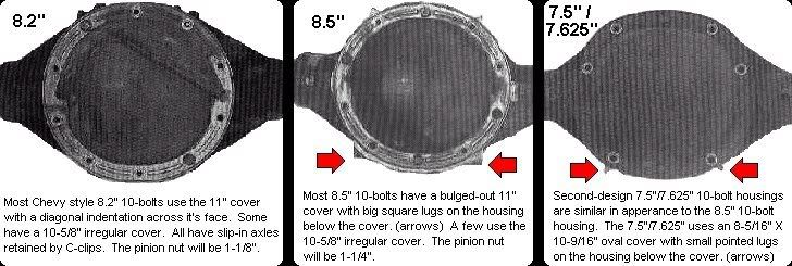

well since you said it has camaro wheels on the back im going to assume that its a GM rearend. more than likely an s10 rearend. you say that the wheel and tire combo stick out about an inch? its more than likely the backspacing on the wheels like blackluv said.
anyways, heres something that might help you tell what rearend is possibly in the truck.
looks at the one to the right. thats more than likely whats in the truck.
oh, and welcome to the site!!

It Could Be A 4x4 S10 Rear End...They Are Slightly Wider
