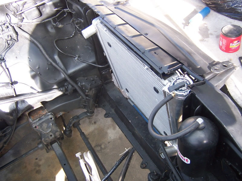

PostPosted: Tue Jan 24, 2006 3:23 am
Swap Specialist Mod
Posts: 2831
well heres a pic of peeroys luvs radiator. it was kinda spendy, but it shows how he mounted it.
as for a radiator, ive got a one out of a mercury sable that i could give you if your interested. i had it in my datsun v6 project and it cooled really well. its a 2 core plastic and aluminum radiator. if you want it its yours. i might even be able to get you an electric fan also.
