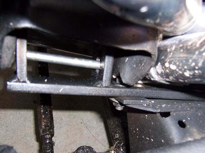

i need engine mounts for a 350 in a 1980 luv 2wd

You can order them from summit, or somebody here might sale you some.

Yeah you could make some motor mounts like mine. They were easy to make too. No cutting or welding on the frame. Bolts right in with the stock mounts. Image
