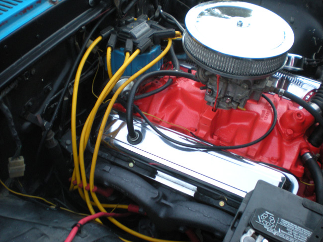

PostPosted: Tue Nov 26, 2013 10:35 pm
I have the old ramhorn manifolds now but have a set of block huggers to put on when I put in my new motor.

I have this set up installed now, and it seems ok to me...
