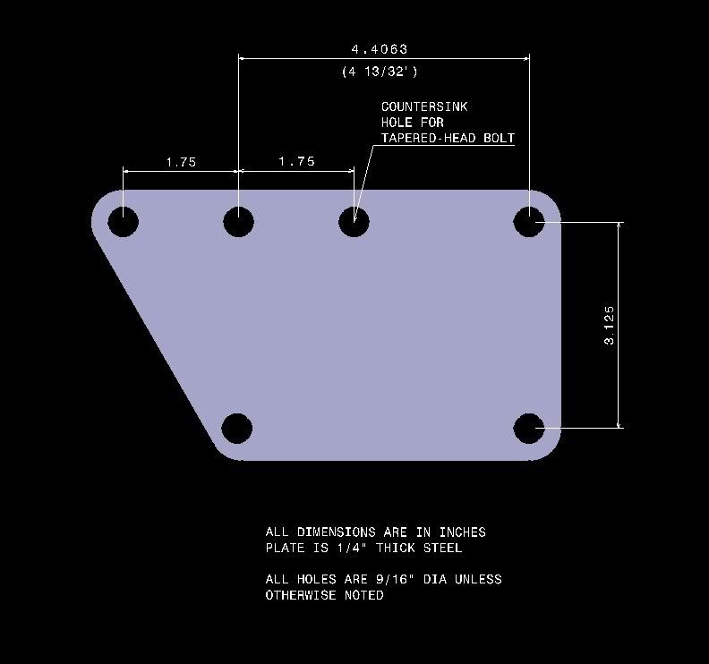

Nice blueprint!
SRAD

That is a nice diagram. As far as motormounts go I think I'll go with ACE. He has both. The transmission tunnel looks like it will have to be enlarged. I may just make a new one and weld it in there. Also have to build another crossmember, which should be no problem. I've thought about building new reinforced shock towers for coilovers, but don't want to if I don't have to. Here in south Texas, for a street truck, ac is a must. If the compressor lands somewhere along the frame, I can just build the frame out a little, if it's there on the crossover, that might cause me to go with a Gen 1 engine and trans. This is my daily driver and occasional racer. Do you have any pics of your mounting setup, or maybe a video on youtube. I would really like to see your truck.

The plate shown will install the LSx engine bellhousing flange, approx 1 1/4" forward of a stock SB engine. The bolt holes to mount it to the LSx block should be .400 as the stock mounting bolts are 10mm.
The c/c of the top bolts of the SB engine cushion is 3.48", 1.74" per side. They should be tapped to 3/8" x16. The tapered LSx bolt hole is between the SB cushion bolts. Uses a 45* taper, different than american bolts. If making a plate be sure to get it just below flush, use a bolt to check. The top to bottom bolt is 3.100" Where as the LSx top to bottom is approx 3.0625" (78mm).
These plates need to be 3/8" thick so that there will be sufficient thread for proper strenth on the 3/8" x 16 bolts. You could weld a piece behind each hole to accomodate the needed increase, if using this offset forward.
When moving the engine forward with this adapter, definintely watch out for oil pan to crossmember clearance.
If you plan to lower the truck use the Cadillac CTS-v or Holley oil pan. CTS is allmost 7" deep and the Holley is almost 6" deep. The truck pan is over 8" deep. All come back before dropping to sump. Use appropiate oil pickup tube and windage tray.
If you are not using a transmission that came with the engine, you may need a special flywheel or spacer.

Thanks Old Rob. Moving the engine forward 1 3/4 is something I wanted to stay away from because of radiator, fan and pulley clearance. However, if the heater hoses and ebrake can stay that would solve some problems. I'm hoping with a little adjustment the LS1 can be shoehorned in there. I can't remember if you are with with ACE or not, but that's how I'm planning to go. I already did the Hooker mounts, and didn't like the way you are limited to their measurements.
