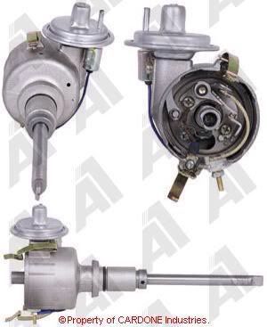

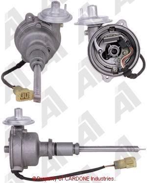

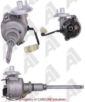

I haven't replaced my points yet, wanting to go to an electric dizzy set up, either petronix or a swap. I read everyone using a 85-86 pup electric dizzy but wouldn't a 81 luv electric dizzy work? Or is the pup a better make?
76 Luv point dizzy from RockAuto~
81 Luv electric dizzy from RockAuto~
85 Isuzu Pup electric dizzy from RockAuto~
