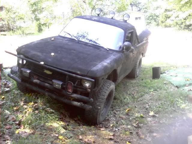

what would be the best kit for a turbo 350 trans its in my 80 c-10 and i want it to shift harder than it dose .
