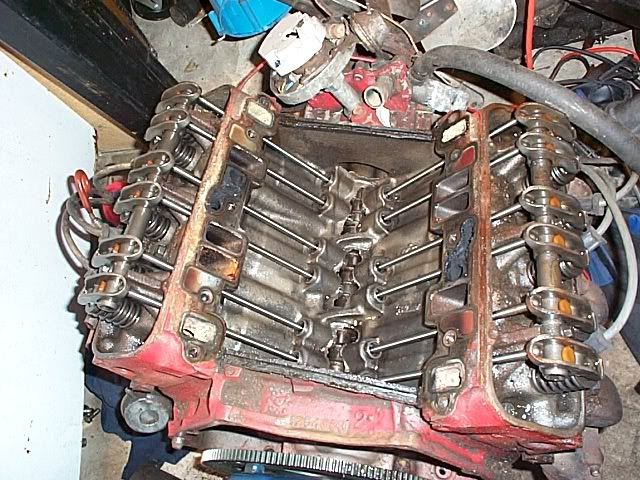

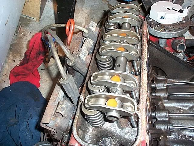

ive decided to do the swap and im in the process of tearing apart the motor and i think it has aftermarket cams i dont know ive never done a rebuild before is hopefully i can find a manual on it dose anyone know of good websites with parts for this motor sorry for so many questions im still learning
thanks tim
