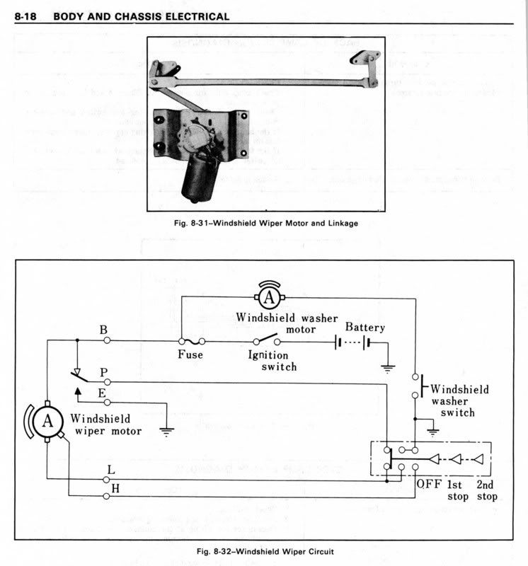

 Post subject: Wipers
PostPosted: Fri Mar 03, 2006 4:15 pm
Joined: Mon Aug 11, 2003 2:35 pm
Posts: 515
Location: NE Washington, USA
There's gotta be a hold in circuit in the motor thru a limit switch that opens on down side and kills power when the dash switch is pushed in. That make sense?
PostPosted: Mon Mar 06, 2006 3:11 am
Posts: 680
Location: Cornelius Ore
I'll try to explain the operation. When the wiper switch is on, power is supplied and grounded at the motor. When you push in the switch to off the ground is transfered from the motor to the switch through that internal contact inside the motor that opens once every revolution. Then the wiper motor continues to run just until that contact opens.-------hope this helps.
You are right, the problem could be in the motor, switch, or wiring.

It was the switch. I got one from a junk yard.
PostPosted: Tue Aug 21, 2007 11:27 pm
Posts: 885
Location: Coburg, OR
Just some additional info on the windshield wiper circuit for those who might not have a manual. I would have suspected the contact points, per step 4. But egg's explanation of the switch makes perfect sense when you look at the circuit.
This is from a series 10 manual -
