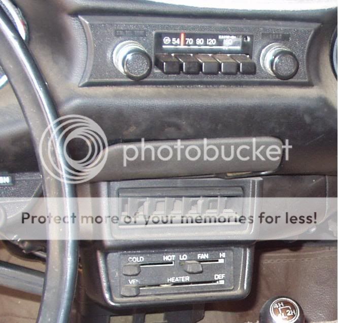

what do you guys do for a stereo in your truck? mine doesnt even have a tape player, i dont know if that was an option or what. has anyone here installed a cd player? i'd kinda like to keep the stock look of the dashboard.
theres my stereo

any of the small DIN size radio will fit. I have a Cd player in my 80. My speakers are hidden in the truck, only the radio can be seen. A home built sub box with 2 10 inch subs behind the seat. It really rocks and I have surprising little money in it.

its not hard to put a cd player in these days, i think they are all roughly the same size i plan to put one in my truck soon :D

you could do what ive seen alot of older show cars have done....leave the stock stero in place and mount a modern cd player in the glove box.

put it in the glove box it really easy i did it in my luv so no one would wanna steel it and it looks so much better in there with the stock radio....if you want i can get you a picture of my install...looks killer

I have a Clairon head unit in my '80 ,looks like it came with it from the factory. any DIN size head unit will fit, you just need to get creative with the wiring to make it all work right. Im not sure but, i don't think they make a wiring adaptor like the one's they sell at wal-mart for other cars. but i don't think it would be too difficult, just get your hands on a wiring diagram for the truck and you should have very few if any problems. Hope that helps ya a little :lol:

I just finished installing a new sound system in my 1980 LUV.
IF?
You are installing a new stereo head DIN & new speakers.
The only wire you from the factory wiring harness is the blue wire that comes out of the original radio plug. The blue wire is the cut off from the ignition key switch.
Everything else should be new.
I highly recommend that you draw power directly from the battery using the supplied
in line fuse. A good ground for your stereo is the screw that holds in the package shelf under the dash. (The left one is perfect for this.)
