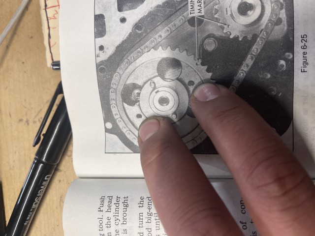

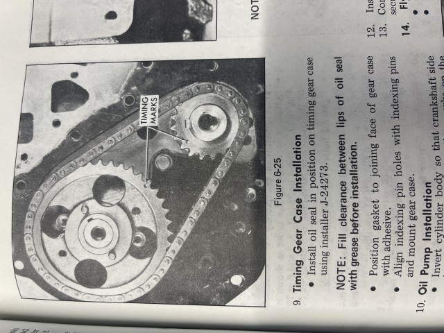

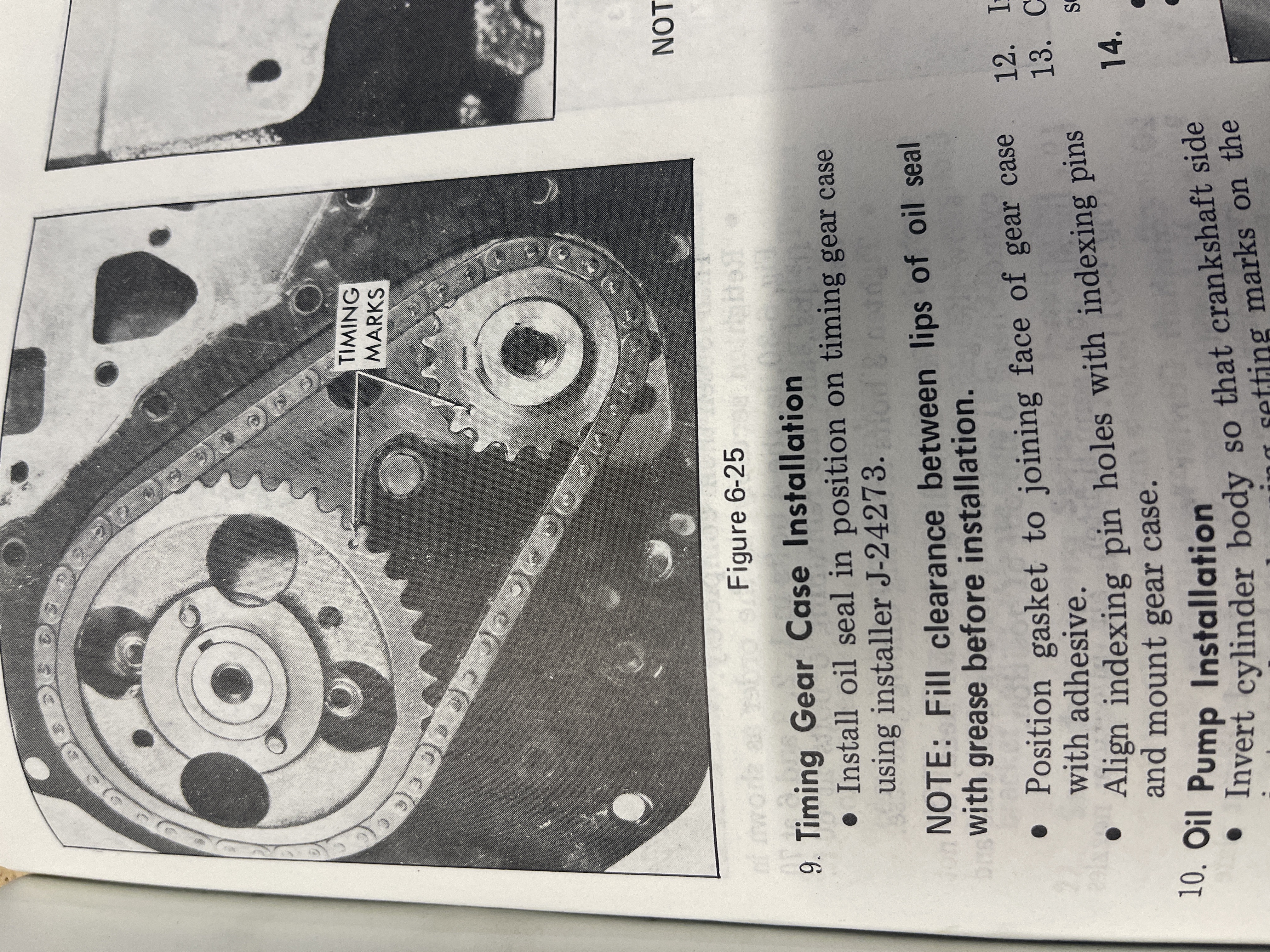

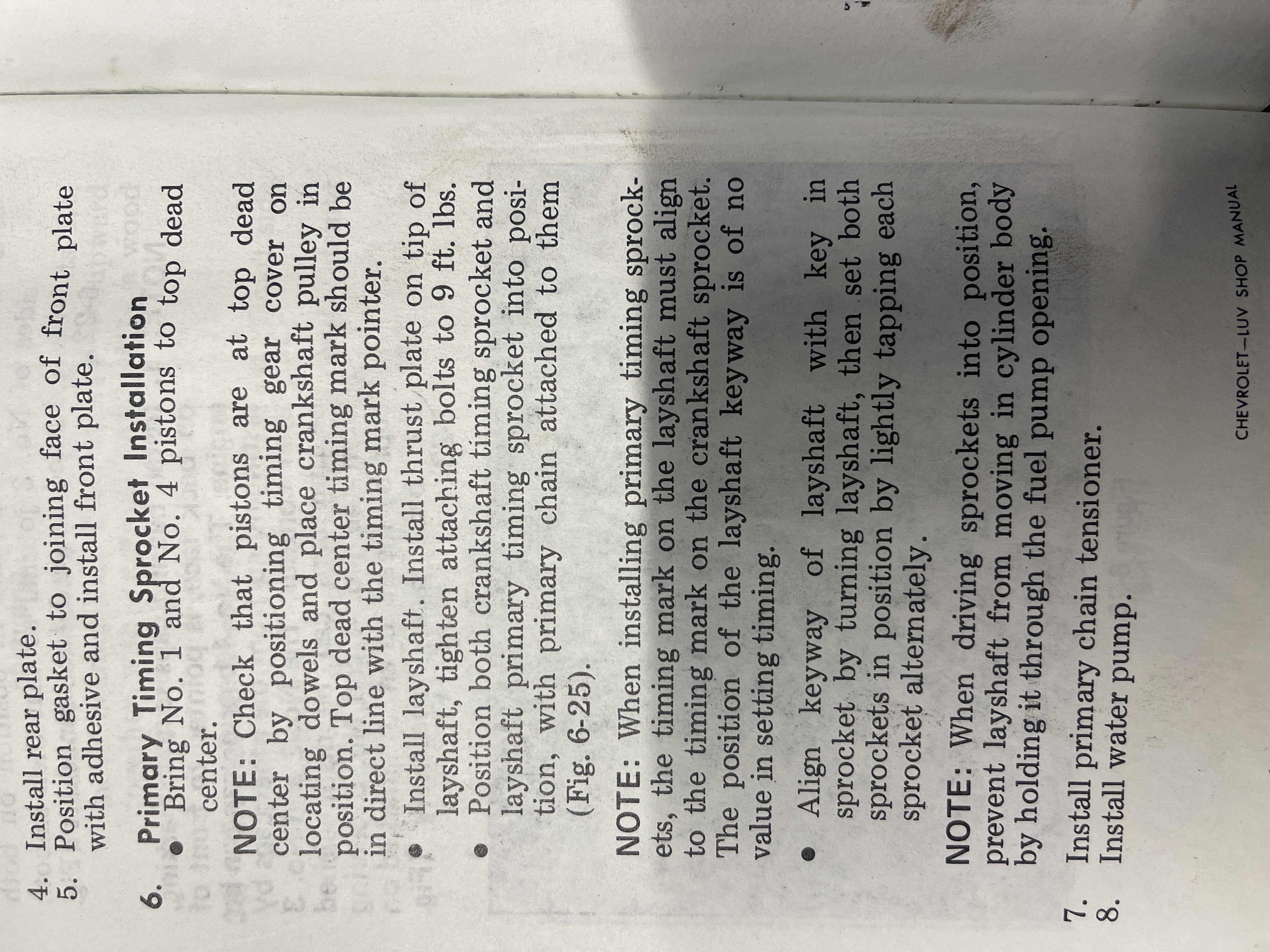

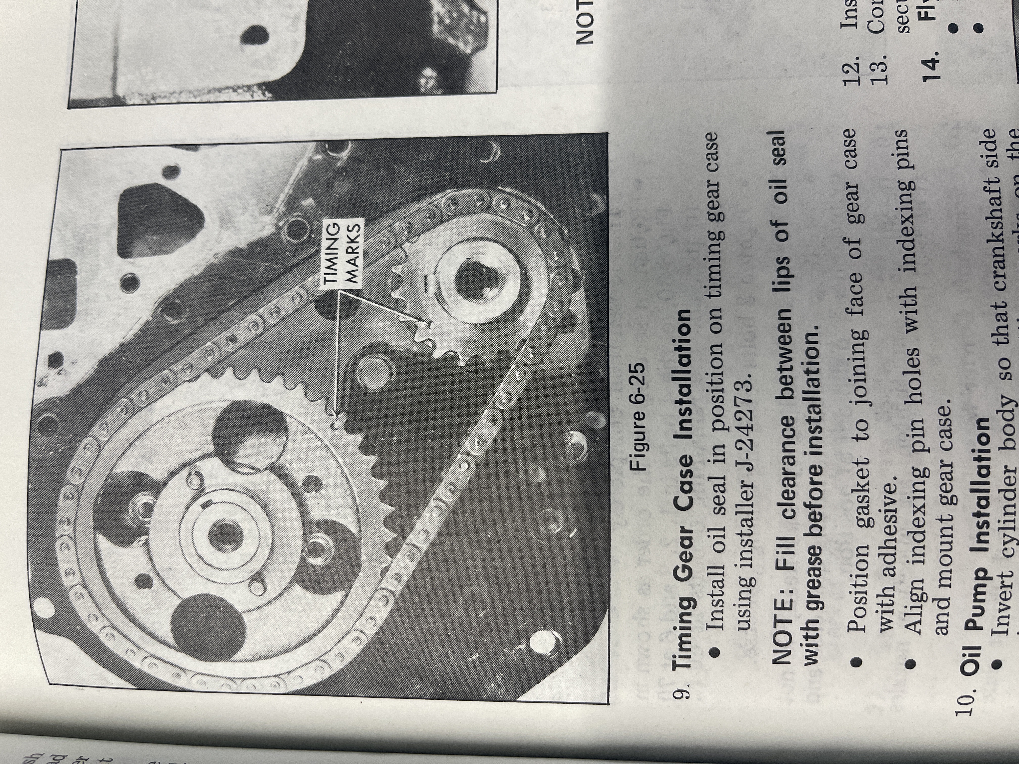

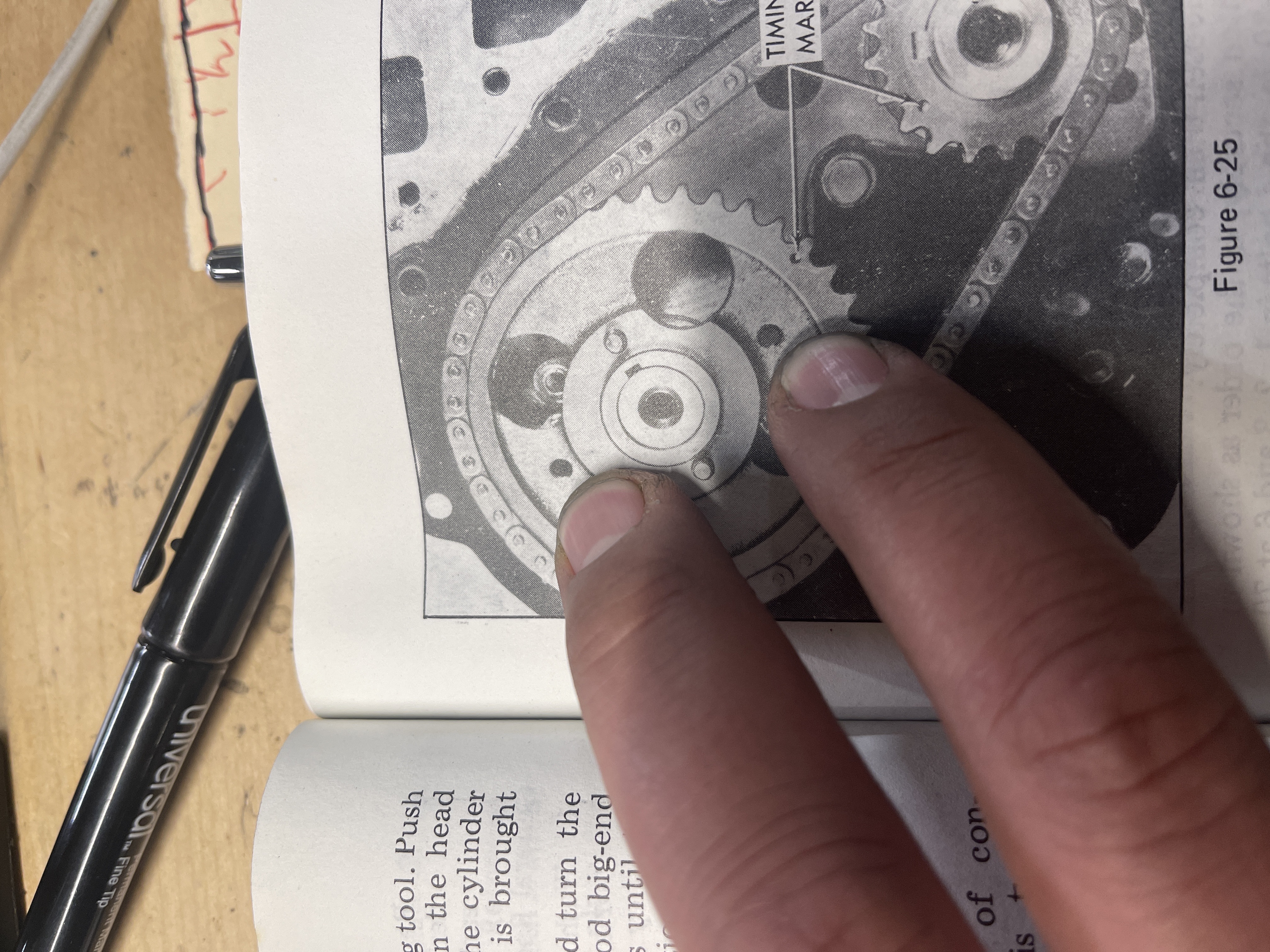

PostPosted: Wed Apr 21, 2021 7:07 pm
Joined: Wed Apr 21, 2021 4:14 pm
I blew my head gasket in my 75 and I’m having trouble taking my timing chain off. Could anyone explain to me how to get it off?
PostPosted: Fri Apr 30, 2021 7:27 am
Posts: 326
Location: Lodi CA
I have the book.
PostPosted: Fri Apr 30, 2021 8:56 am
Posts: 326
Location: Lodi CA
Here goes a picture. If I can remember I think you use a bolt to push against the block and it pulls the sprocket out.
