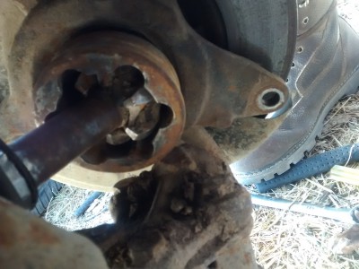

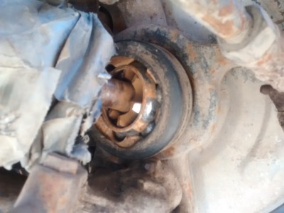

I'm having trouble finding CV axles, too, for a '79. The right outer CV joint needs a new bearing-thingy (pics below). I'd appreciate any ideas on how to get one!

File comment: missing bearing from right CV joint

File comment: left CV joint: all there!

Good luck on the front cv joints. I've had 6 different companies send axles listed as compatible. None were.
I've been searching for over a year. I wish I had better news.
