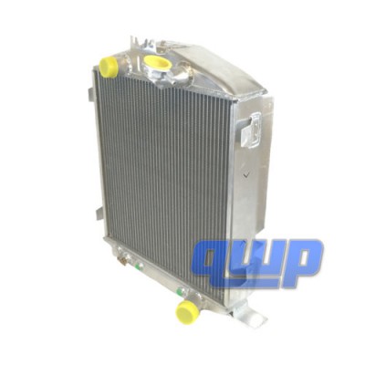

try this one if you have a body lift and motor swap with chevy v6/v8
http://www.ebay.com/itm/Aluminum-Perfor ... ~c&vxp=mtr

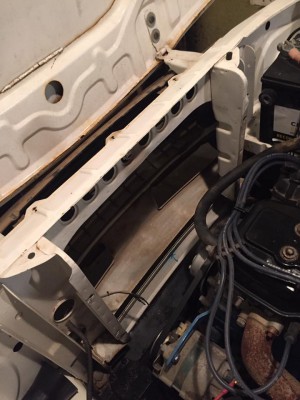

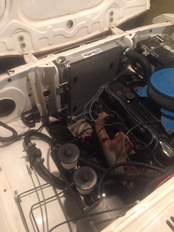

I ended up getting this, it was just expensive:
Griffin Aluminum Drag Race Radiators 2-26135-X from summit. I cut some aluminum brackets and used rubber grommets to attach it.

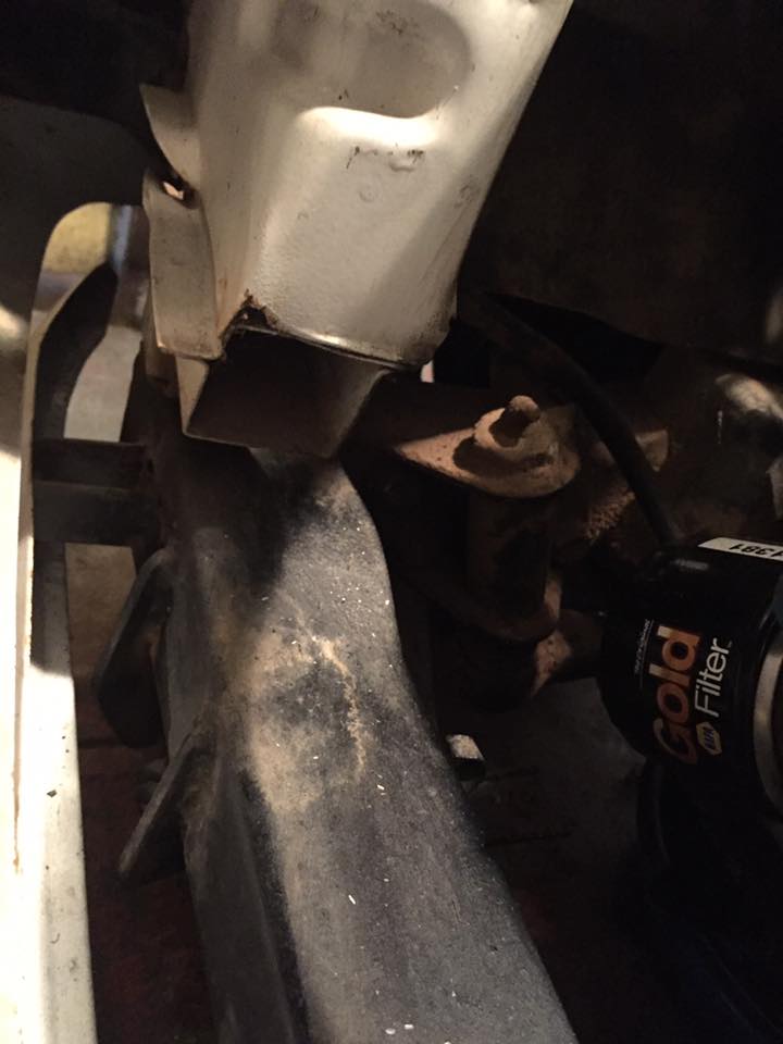

I didn't realize it at first but I think the reason I didn't have to cut anything myself was because the previous owner cut the area on the bottom of the opening:
