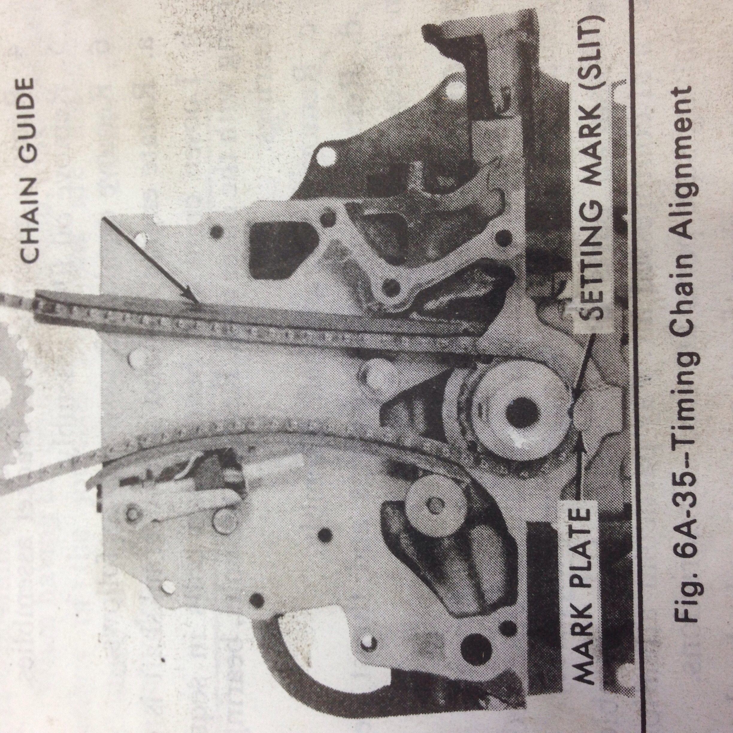

Trying to fix my screwed up timing chain and pulled the front cover. Looking for the timing mark (slit) on the crankshaft. Is this it?

PostPosted: Thu Jul 23, 2015 4:07 pm
Posts: 131
Location: Lewiston, idaho
It's the only slit I could find, but it that's it then it's up top at 0degrees when the timing Mark should be on the bottom...
P.s. I have a manual but the picture sucks a**

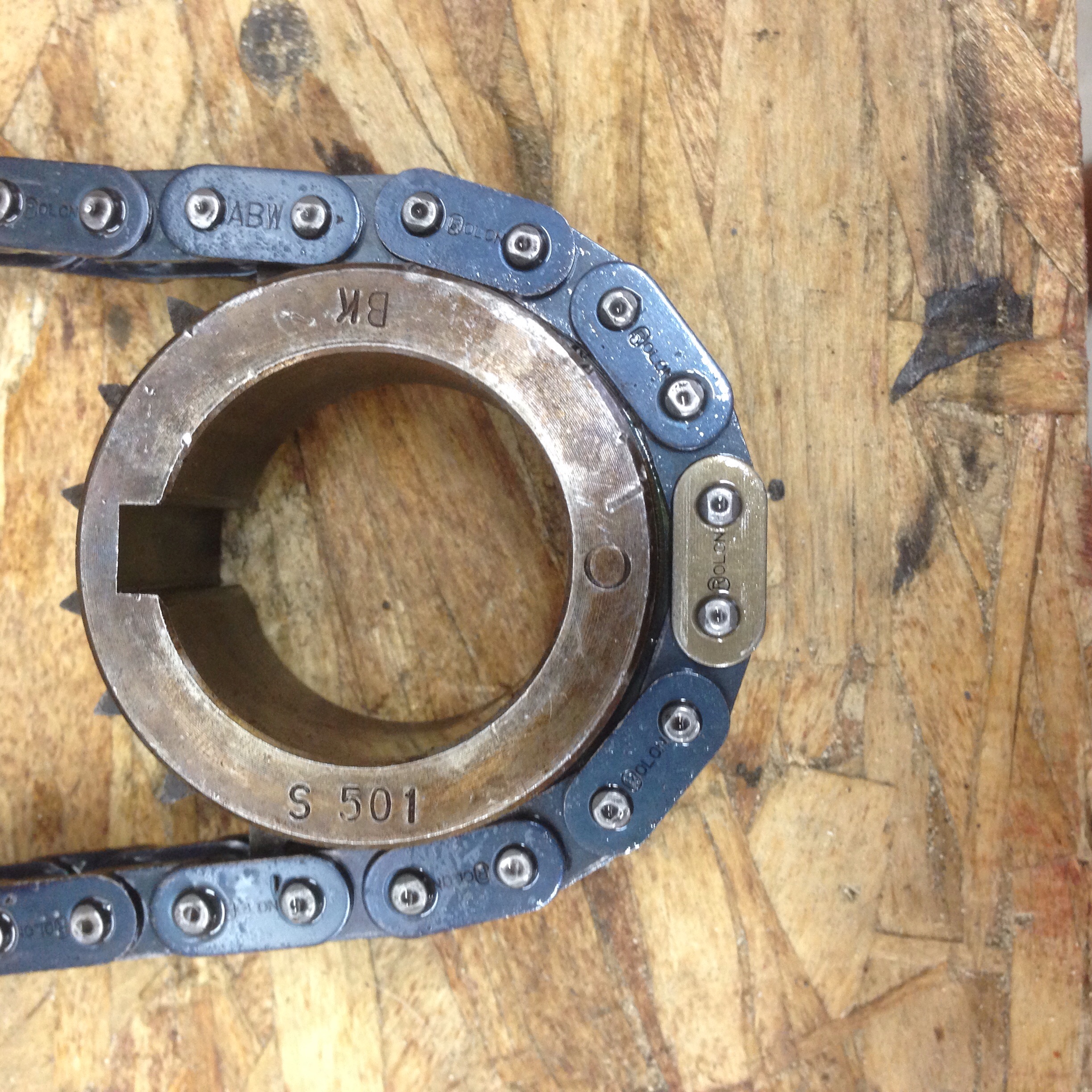

PostPosted: Thu Jul 23, 2015 5:02 pm
Posts: 131
Ok I think I got it but damn the manual is confusing as heck. I think the mark in the crank shaft timing sprocket is how it needs to be. See pic.. Is this correct? Mark plate on chain lined up with circle Mark on sprocket...

PostPosted: Thu Jul 23, 2015 5:03 pm
Posts: 131
Manual says slit but all I see is a circle marks.. Ugh....

PostPosted: Thu Jul 23, 2015 5:53 pm
Posts: 131
Waiting on confirmation that that is the right timing Mark. Don't want to have to take this bitch apart again..
PostPosted: Thu Jul 23, 2015 7:07 pm
Posts: 680
Location: Cornelius Ore
Looks correct. I never went by any slit, dot, or timing link. Basicly put the key way straight up and the pully should point to 0 degrees ignition timing. Then look behind the top timing chain sprocket and should line up with a "slit" or "v" at the top. If not, turn the crankshaft one more revolution to line it up on top correctly. At this point the distributor rotor should point to #4. If not, just change the spark plug wires in the cap instead of redoing everything. 1-3-4-2 counter clockwise.
