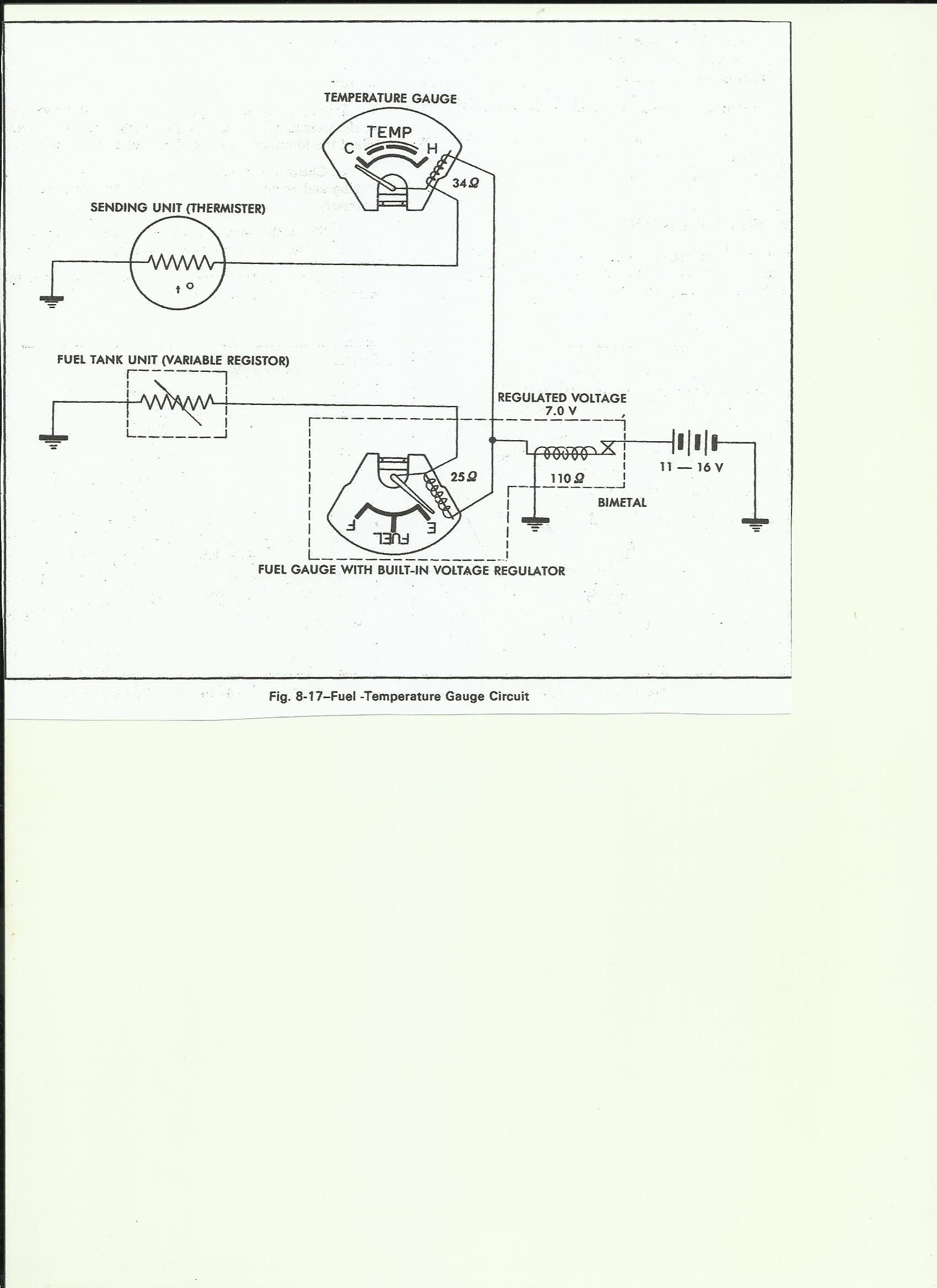

EVERYONE: Please let people know what truck/year/engine you are asking about when you want help-sometimes it makes a difference.
This is info on a 1980 gas LUV, hopefully this will give you what you need.

Does your temp gauge work ok? If so that will eliminate the gauge regulator as the problem. Then you are left with probably a sender ground problem most likely.
