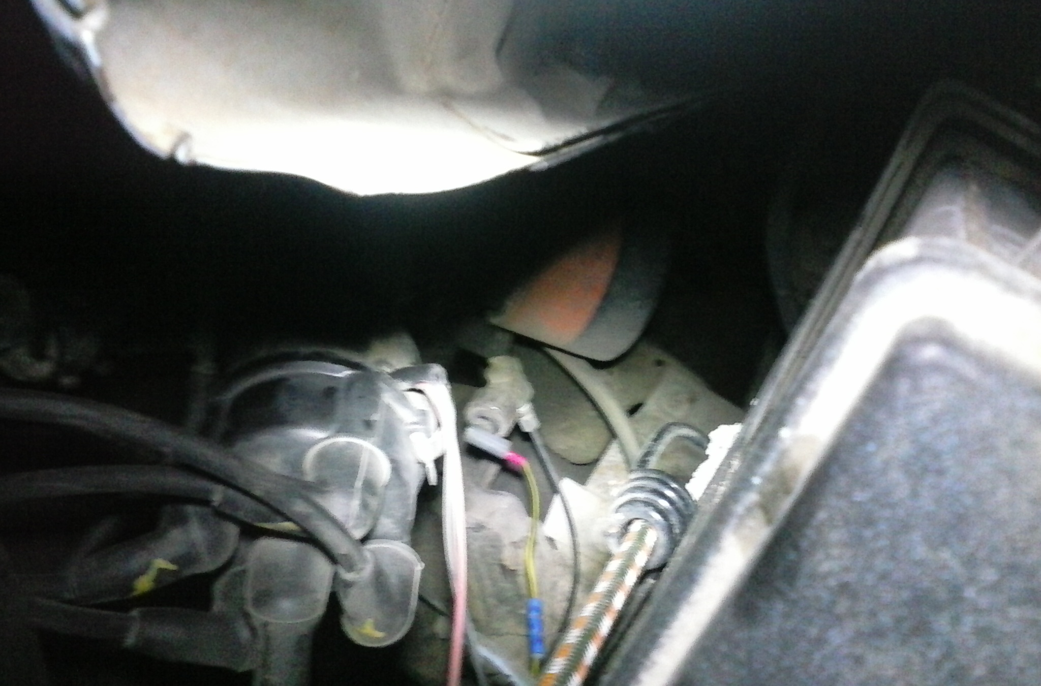

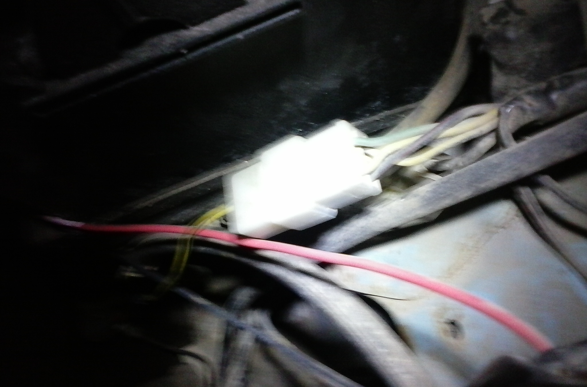

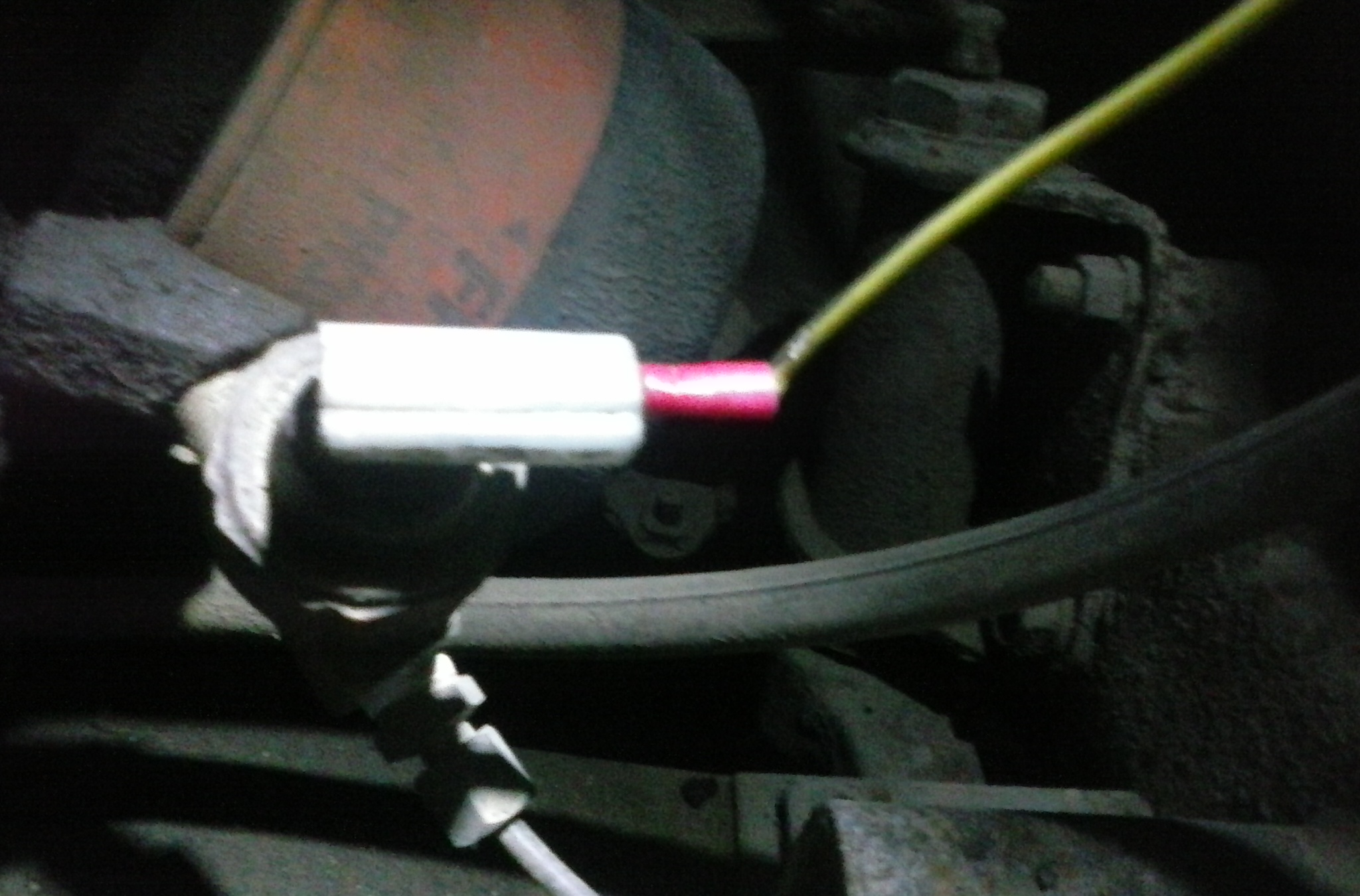

The wire to the sending unit doesn't appear to be grounded anywhere, at least not on the engine side. If i detach the yellow and black wire from the TSU, it immediately goes back to "C". Could there be something faulty inside the TSU that would be grounding it out internally? I will probably take off the instrument panel out tomorrow to see if perhaps i've grounded it in there somehow. I'll save the cussing and finger skin for then i guess. I took a few pictures with my (ghetto) walmart phone so they are kind of crappy but here's what i am looking at. As you can see the wiring job isn't exactly top notch but it definitely doesn't seem to be wired to a grounding location anywhere.
EDIT: Am i hooked up to the "oil pressure sending unit" instead of the temperature sending unit? Hell, they might be the same thing for all i know. I am just researching, walking outside and testing, coming back inside, researching, walking outside and testing... so on and so on...

PostPosted: Tue Jan 27, 2015 10:30 pm
Yeas, that is the oil pressure sending unit.
PostPosted: Tue Jan 27, 2015 10:34 pm
The temp sending unit points down from the intake manifold. It's kind of hard to see. It's vertical.
PostPosted: Tue Jan 27, 2015 10:36 pm
Like drummer said, it's under the intake. It's on the front half of the intake below the thermastat.

PostPosted: Wed Jan 28, 2015 4:08 am
Posts: 680
Location: Cornelius Ore
Temp unit should be a yellow wire w/black stripe. Oil pressure is yellow wire w/white stripe.
PostPosted: Wed Jan 28, 2015 10:30 am
Joined: Thu Sep 19, 2013 1:49 pm
Posts: 53
Found it, fixed it, works great. Thanks for the help!
