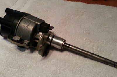

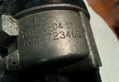

will this electric distributor work? clean and fully tested and functional electronic distributor from a late 80's isuzu impulse with the 1.9 engine. Will fit many nissan and datsun engines as well

i cant tell you for 100% sure
but these are the equivalent part numbers for the one I used from an 85 Isuzu trooper 1.9 I pulled these off of rockauto.com 8942537440, 8942537441, 8942537450
I cant say for sure that these not matching up to that distributor meaning that it wont work, but it isn't the same as what I used. it looks a bit different on the plug and the vacuum diaphragm on that one isn't pictured so I cant compare them
the one I used is currently $136 on rockauto remanufactured by cardone. the pertronix is cheaper unless you get the 85 trooper dizzy on sale or from a yard. since there are no points to wear out a used one should be just fine try ebay

I think it will. I have a 1.9 in my luv and they all have the same dist.
I think I even have a spare one that I ran in a 1.8 I'd sell if it doesn't work.

it should drop in im looking at one out of an 87 on rockauto and it says its a g200 so should drop right in same as the one I had. the 2.0 that wouldn't fit has a shorter thicker shaft and a different cap from what I can see on rockauto
PostPosted: Sun Nov 23, 2014 3:37 pm
Does it have a wire harness with a plug on the end of it? You will need the control box that mounts to the coil also, to make it work.
