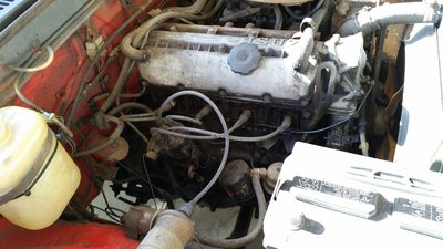

This how i looked like b4 i started to change them
 Post subject: Re: tune up
PostPosted: Fri Apr 18, 2014 11:09 am
That looks correct, 1342 going counter clockwise. Number 1 is closest to the front.

I don't understand the confusion - you've got a photo showing how it went.
