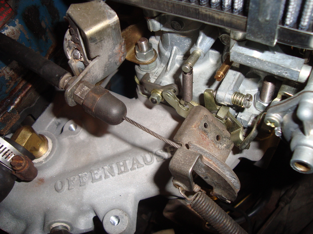

PostPosted: Sat Apr 19, 2014 7:01 pm
Posts: 297
Location: White Bear Lake, MN
Does this help?
