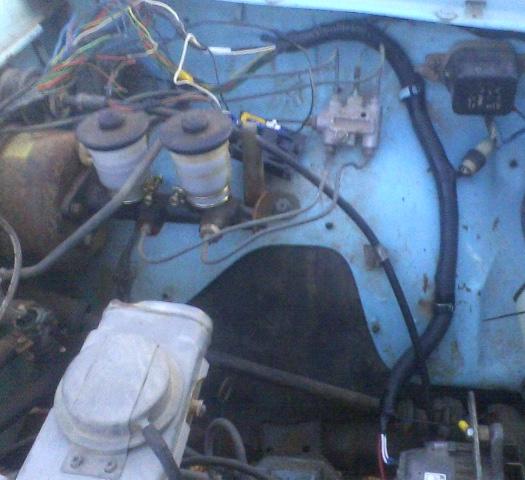

File comment: Circled in red are hack spots (hard to see crappy cell phone pic)
Areas circled in red are what bother me. Crimped and twisted together wiring with tape (you should've seen how much tape I took off!) Definitely a issue for me, harness is probably full of electrical resistance and corrosion, along with the fuse box needing replacement. The worst of the hacking is in the wiring that goes to the bottom of the fuse box.

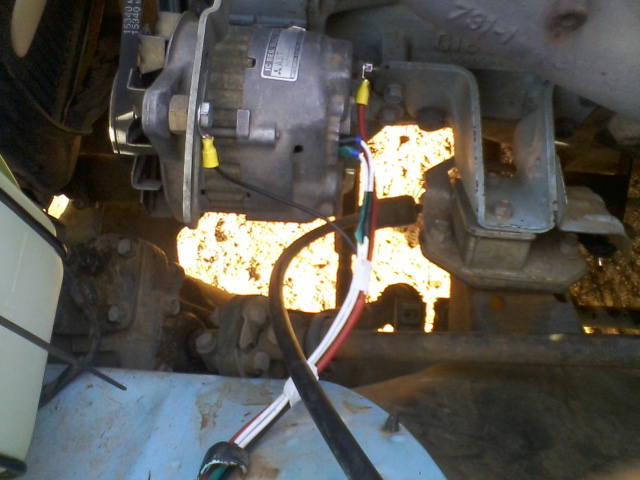

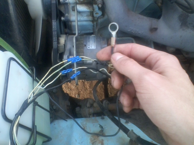

Also...
File comment: More hack spots and a mysterious wire. Black, goes from there thru hardness to voltage regulator.
...where does this wire go? I'm pretty sure its a ground, just want to know if it needs a specific spot. When I stick the positive needle from the multimeter to one of the fuses in the fuse box and touch negative needle from multimeter to this wire I get 12 volts. Solid black wire goes through the harness to the voltage regulator.

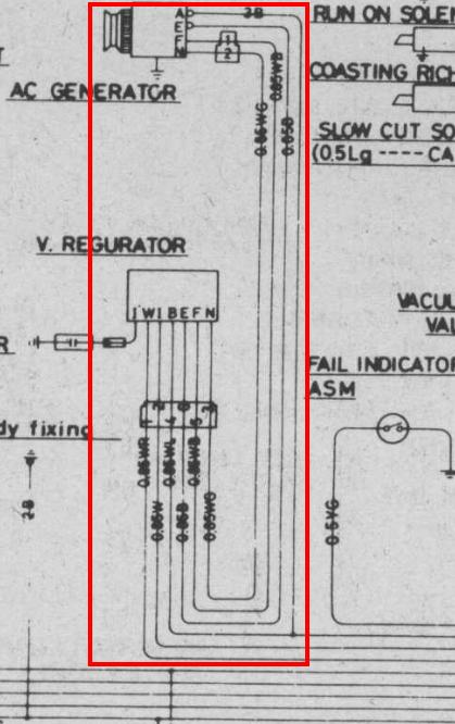

According to the Series9&10 wiring diagram this should be wire E for the alternator? But I don't know where it would go there doesn't look to be a spot for this wire on the alternator? If it is just a ground I could connect it to one of the mounting bolts for the alternator?

Removed the hacked up wiring for the alternator/voltage regulator and re-wired it with new wiring. Used the heat shrink type crimp connectors. I hate using crimp connectors honestly, but better than twisting and taping wires. Also, soldering iron seems to have grown legs and disappeared :(
File comment: New wiring for alternator/voltage regulator.
I figured I would have fun with it while I was going through the harness. All ignition wiring is labeled with blue, lighting is labeled with yellow (as was stock wiring?), and voltage regulator/alternator labeled with white, taped to hold it together underneath the coverings, and to aide in wiring identification if I ever have to go back through.
Removed the voltage regulator wires from the stock fuse box and ran them to a new 6 slot ATC fuse common hot feed panel. When running GEN light is no longer on constantly, and FASTEN SEAT BELTS light turns on with the key and turns off about 30 seconds after. Then turns on for another 30 seconds after engine starts, then shuts off again. (Normal?)
...and still no voltage regulator issues. Battery is charging normally with 13.9-14.1 volts.

Good job on the rewiring, looks quite professional. Not surprised that fuel pump circuit from Z car works for the Luv, as the Nissan 240 Z had the very same fuel pump as the Luv. If you ever need to order a stock Luv fuel pump and they say no listing, just order one for a Nissan 240 Z which they probably do have, same pump.
That whole pump, relay, regulator circuit was mandated for safety only. In an accident the motor should stop, alternator will then stop, fuel pump will stop, and not continue to pump gasoline on a maybe burning vehicle. All vehicles now do this and that was the way Luv decided to do it.
