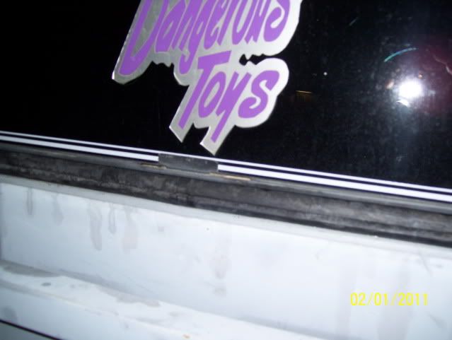

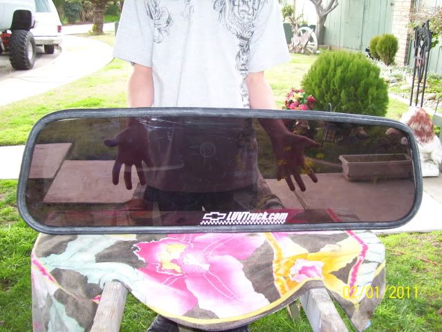

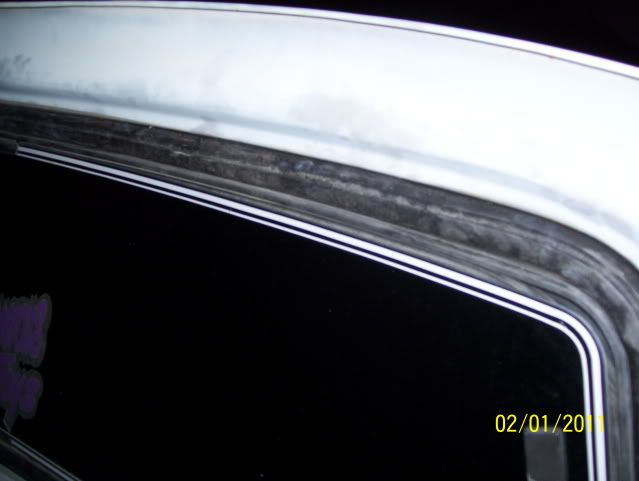

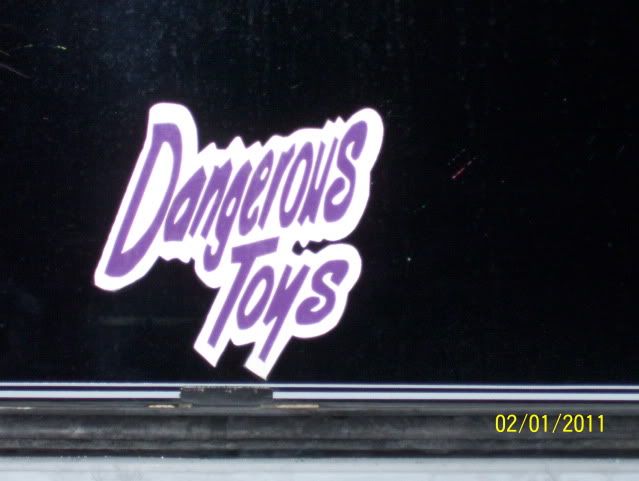

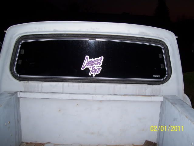

did you have any luck with the solid rear rubber seal if not let me know I have a new in the sealed package fits great I used one on my luv and it is still on my luv works great I will see if I can get some more pics of it today

this was a few years back and I still have the same one on my luv truck as of today
budbondo wrote:
this is the new window rubber on the stock glass it fits great and then i put the new rubber on my flex window the window is a lil smaller but it fits great
