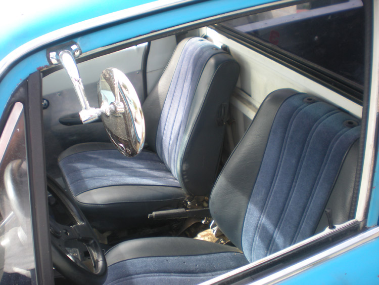

I just found these BMW 325I seats that fit pretty good and the two outside holes in the floor lined up perfect with the seat brackets. There are only the holes on the inside to drill and the inside front rails will need a spacer as they are 1.5" above the floor. I was going to use some tubing as a spacer.
