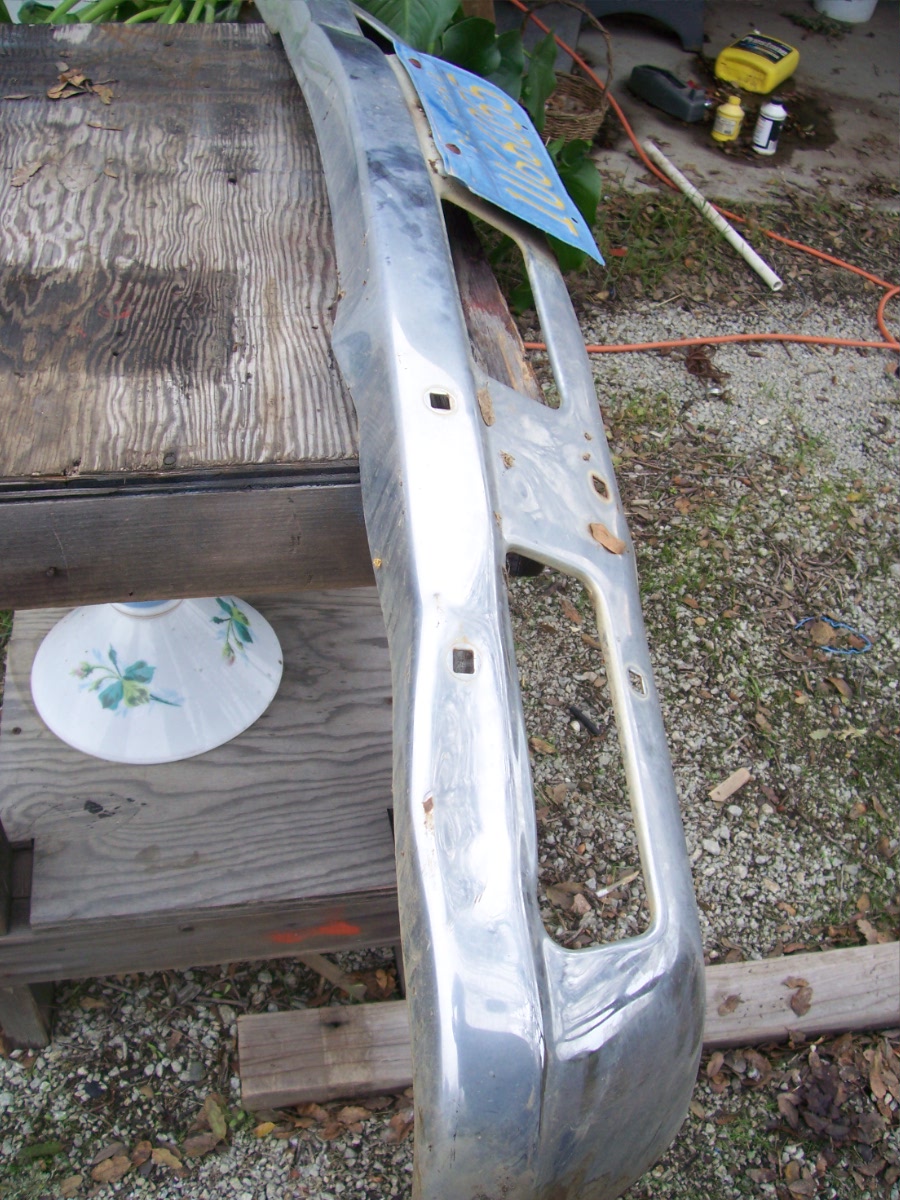

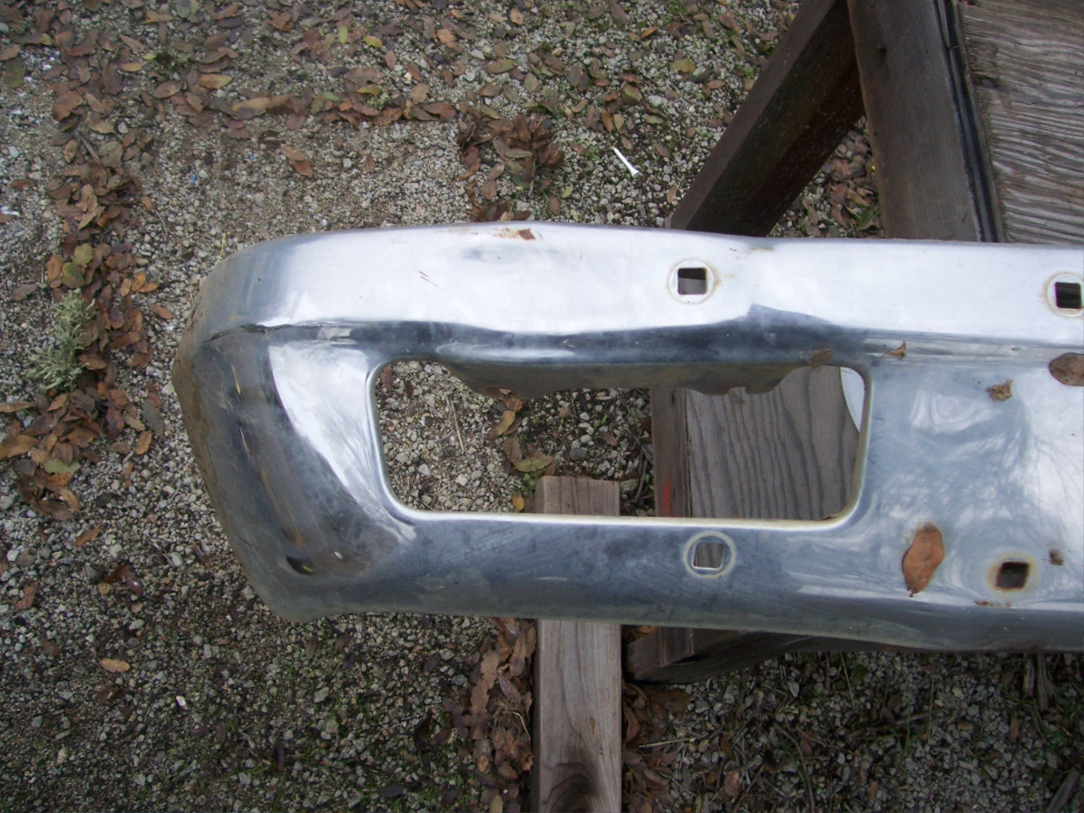

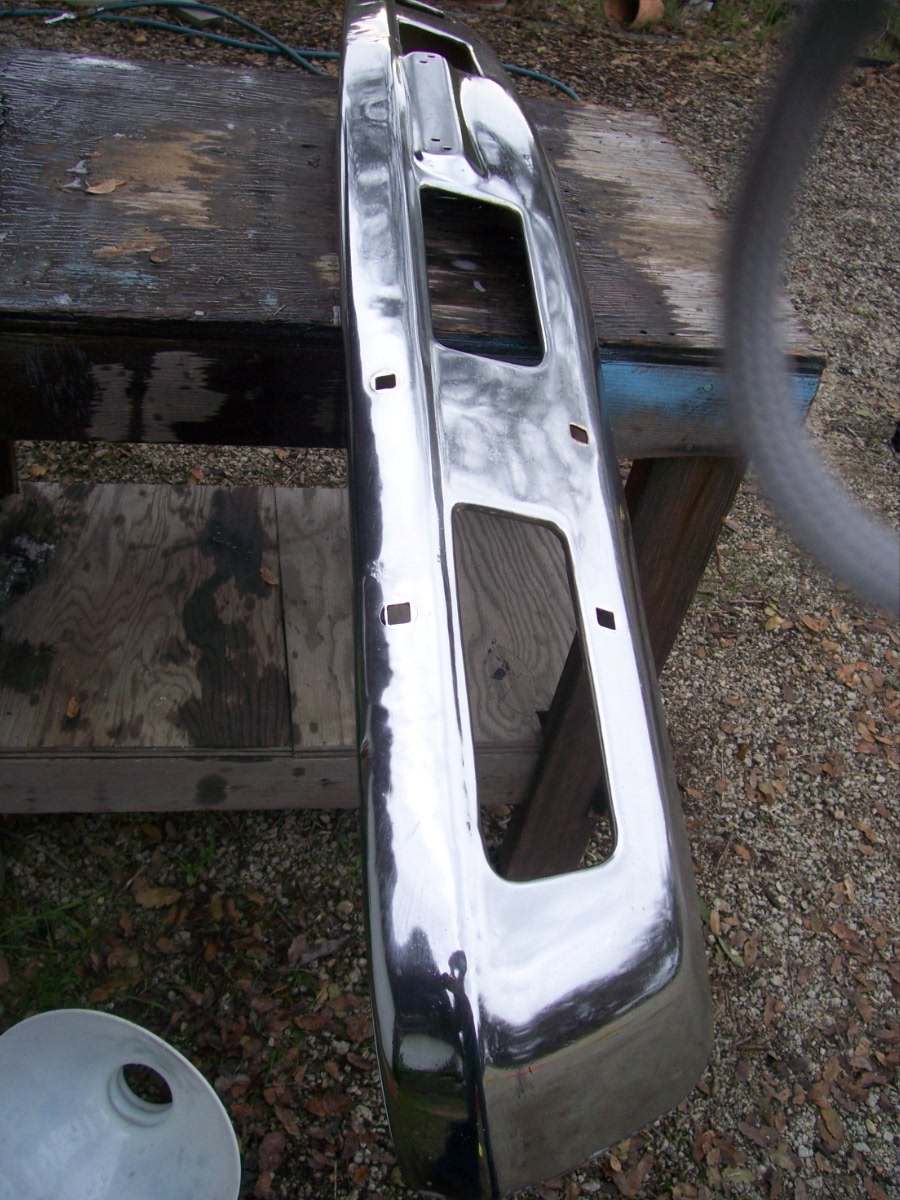

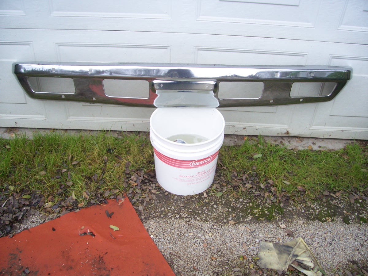

I didn't take any pics of before and after on earlier attempts so I did this time. This was a pretty marginal bumper to start but it will give you an idea of what I'm talking about. Finished results are not perfect. There are dimples and waves. But the shape is right and on anything other than a very straight truck this will not look out of place.
Sorry about the pics. Not the easiest thing to get good photos of with all the reflections.
File comment: after
File comment: before 2

forgot one...
File comment: after 2
