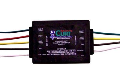

so, i bought new trailer lights — that's what was on it, but they were all corroded. typical setup w/ one wire for brake light/turn signal, one wire for taillights and a ground. how i have it right now is wrong b/c it can't tell what's brake light and what's turn signal. when i hit my brakes, the turn signal indicators on the dash both light up, as if i had both blinkers at the same time, exactly in time w/ when i hit the brakes.
everything works, just not exactly right. if i just have my taillights on or just hit my brakes, it's fine (except for lighting up my turn indicators w/ my brakes). and when i hit my brakes, it cancels those out.
i ran the turn signal and stop light down the truck to the back, then butt spliced those with the (r) brake light/turn signal and another brake light that bridges across the back bumper to the (l) taillight, where it splices in in the same manner as the right.
it's clear the problem is that it can't tell which is brake and which is turn, i just don't know how to correct that.

The trailer lights you bought are 4 wires,ground,tailights,right and left blinkers.The brake lights work through the left and right turn wires,like on older cars and trucks.
The LUV has a 5 wire system in which the brakes and turn signals have their own wires.
Here is a pic of the converter you need.

Thanks Ripper for the detailed info and picture. I was on my phone when I posted, which is why my reply was so short...

cool, thanks. no idea why i didn't think of this when wiring up. doesn't look like something i can pick up at the auto store, but i'll check. thanks!

You should be able to pick one up at most any auto parts store,usually found in the truck accessories,or any RV parts dealership.
