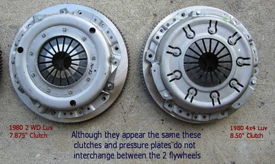

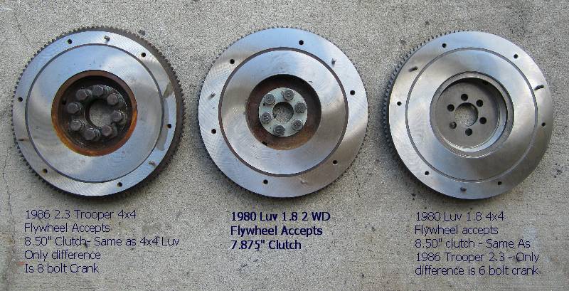

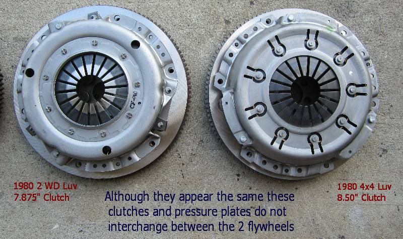

Well I don't know how one would find one but my engine builder came up with a 6 bolt flywheel that accepts the 8.50" clutch (my 1980 2WD version was different in that only the 7.875" clutch would fit it). The pins and holes are in different locations but the flywheel looks otherwise identical. Must be a one year only 4x4 specific part....Man what a headache!
I'll post pics later.
