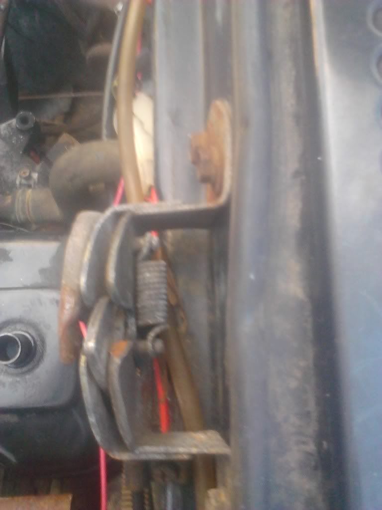

My bad luvstruck, had a busy week sorry if they're a Tad blurry my phones been thru hell and back

Bamaland101, Thank you your trouble. From that pic, looking down at mine is the same as yours. The front view is where the other spring is located. Also I will shoot it with some good penetrating oil and see if that will help.

Here is a pic of mine, the big spring below the latch in front pushes the hood up after the other one has released the latch.

Thanks Tilted. Really clean new under your hood, and that latch looks brand new.
Found out that the front hook on the latch gets pushed down, and that does the trick. Mine is bent way up as if someone repaired it. Guess I need a new latch.

Hope it helped. and actually my engine compartment is really dirty as it is hard to tell my hood latch has been chromed, but that will do that sitting for 14 years. :(

The pop up lever is definitely messed up. Instead of curling over the top of the latch like in both photos, it's bent almost straight up, and at the pivot point it's pressed in. Anybody got a good hood latch for sale?
