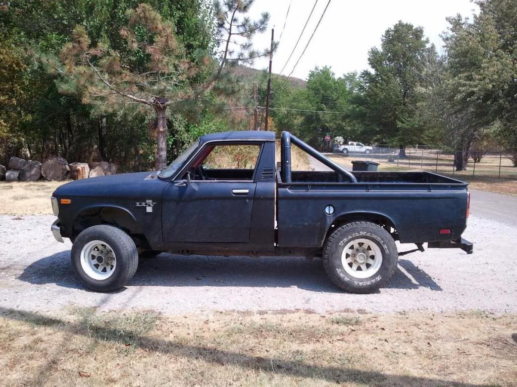

Just try to see if i can post a picImage
