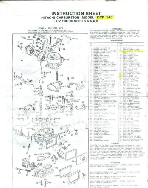

so jumping forward i found the carb kit directions last night and went over every single thing i could think of,
i had posted the other day about check ball placements and it was bugging me still. well i really think the idiot took parts from a DCH and put them in a DCP
(your carb had parts missing on it- but he had some of the parts so he used his old ones.)
according to directions (he had this as well) there is only ONE check ball and its nylon.
MINE has TWO!! i never had the carb EVER opened so i dont know what has been done to it changed wise with his old parts. i am noticing a discrepancy between the dcp 340 carb image and my dcp 340 carb on the truck
part # 65, and 66 are on mine however part number 67 the upside down crayon tip looking weight is NOT on my carb but part 65 and 66 from a DCH 340 a weight with a check ball
http://i363.photobucket.com/albums/oo71 ... fparts.jpg
there are TWO checkballs on a DCH,
DCP shows 1 check ball

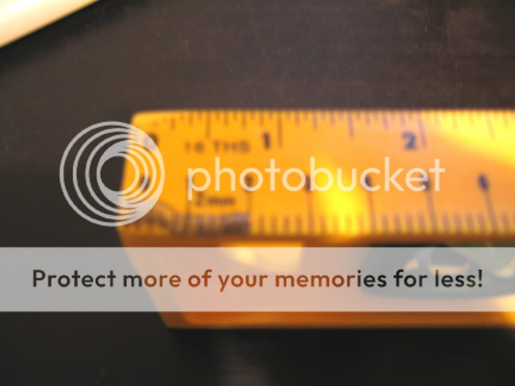

bottom line is my carb screwed up. i know the neighbor wont admit to it if it is, so can someone please visually inspect one?
http://i363.photobucket.com/albums/oo71 ... LTERED.jpg
What part is this?
What is it for?
How Do I test it?
Where do i get a new one?

Ok so I looked up all of my old data books that I could find on the Luv. Also some leftover carb kit data sheets I have. 72-73 used DRJ 340, 74 used DRJ 340C, 75-78 used DCP 340, 79-80 used DCH 340. The C in DCP,DCH means automatic choke model. Looks like you should have a DCH model for yours, so now what? Someone maybe repair/exchanged the carb early on in its life?
Anyhow the DRJ, and DCP models have one input check ball in the accelerator pump well and a needle,weight, and spring in the output port under a screw cap. The DCH model has two check balls, one in the accelerator pump well and another spring loaded ball in the output port. Looks like they went from a needle thing to a ball in the later models.
I doubt if the the ball being plastic or metal makes much difference. They may have just went with a cheaper material later. Anyhow you may be really confused by now, sorry, but that is what I have found though.

i recieved this for a response, oddly i believe if this is the set up its supposed to be that this "missing" ball could be the cause for what was told to me i have a vacuum leak somewhere by a auto shop in town that i called and explained the sound the truck was making -
I believe there are only 3 balls in the carb.
2 steel balls are used in the accelerator pump system. One, spring loaded, below the piston to prevent pressure from flowing back into the float chamber on the down stroke but lifts up to allow gas in on the up stroke. The other steel ball is spring loaded on the injector nozzle in the primary barrel. It is pushed up out of the way by the pressure from the pump to let fuel through on the down stroke but closes to prevent sucking air in on the up stroke.
1 ball is in the secondary vacuum diaphragm.
does this make sense to anyone else?

Yes it makes sense. That is exactly how the accelerator pump system works in your carb.
