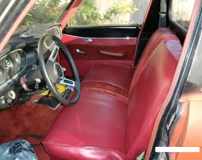

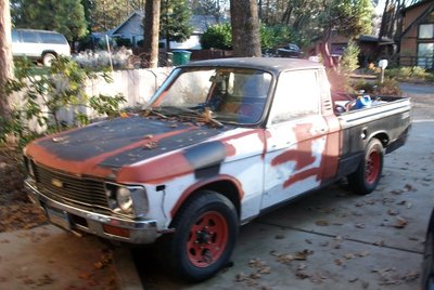

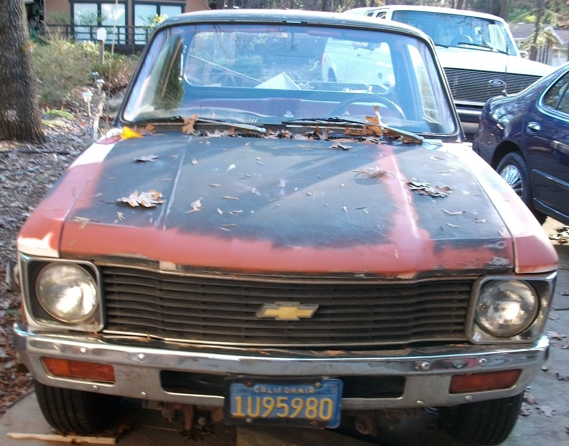

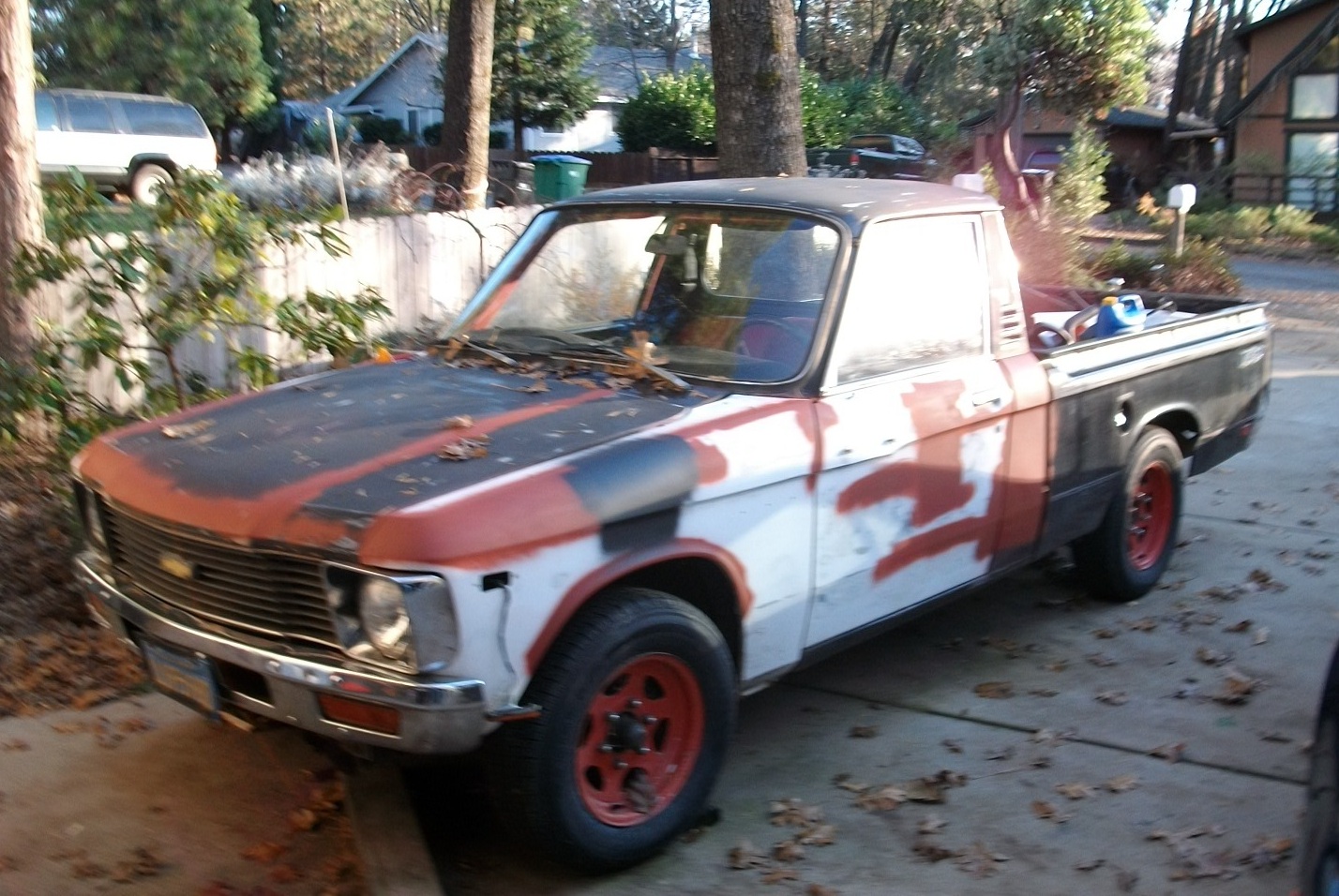

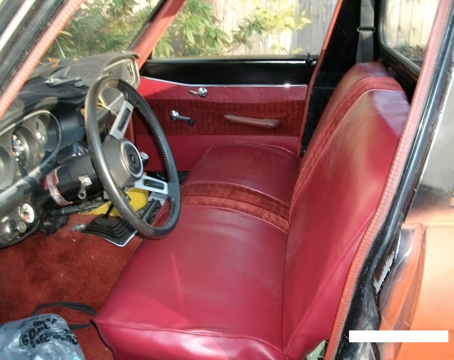

The truck finally passed its smog test. The final piece to the smog puzzle was a smog pump. It took a mechanic with old school troubleshooting skills to discover that the air pump was not providing enough air pressure to the air injection system. After 5 years of sitting, a new smog pump, new carb, new EGR valve, new fuel pump, new brake booster, new master cylinder, new brake pads, new clutch pedal bracket, 2 new fenders, new drivers door, new seat cover, 4 new tires, 4 spoke wheels off my 4X4 parts truck, a tach and a oil pressure gauge. $800 in mechanics fees, $1050 in parts (consumable and non-consumable).
Now at least I can drive it. I still have a long way to go. I need door weatherstripping, a radio, and of coarse I need to paint it. Fun little truck to drive. No wonder this website was formed.
