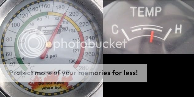

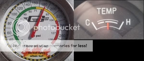

I had to drive 20 miles down the highway and noticed that my temp gauge was up 3/4 of the way.
I have replaced the thermostat and water pump, but it still is elevating past the 1/4 normal mark on the stock temperature gauge.
I replaced the radiator cap with one that has a temperature gauge.
Here are the readings from the cap-gauge compared to the in-dash dash. After letting it idle for some time in my driveways it seems to be topping out at 200. Is 200 running to hot or is my stock temperature sensor giving a false reading?
170
190
200

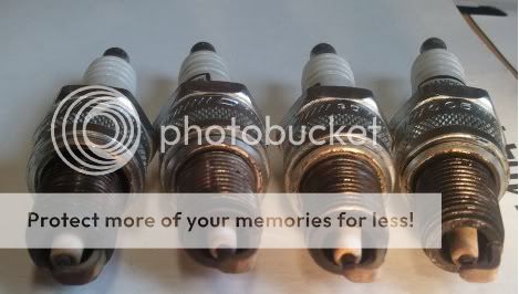

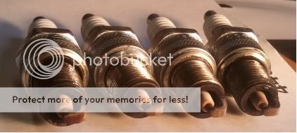

Here are my plugs no leaks and the coolant is clean.

To me it looks like it's pointing at 160, 180, and 190. If you have a 180 thermostat in there, I'd say 190 isn't too far off.
 Post subject: Re: Over heating?
PostPosted: Sat May 21, 2011 10:03 pm
I agree. If you want the stock gauge to read lower when at 180, maybe change the sending unit.
I have two trucks that both barely get off the cold mark. I plan to try changing the sending units to see if it that fixes it.

What temp should I start being worried at?

@ Ben, Oh you are right!
PostPosted: Sun May 22, 2011 9:06 am
Under normal driving conditions I would worry @ 200 or more.
I would be watching very closely at 200, and shut it down up around 210-220.
