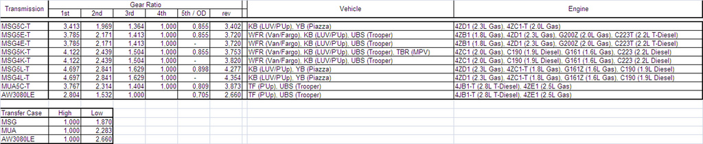

79/85 its the same MSG trans as far as gearing, case size and spline count.
86/87 is the hard to find 14.5% O\D trans, same MSG trans with a 5th gear (case is 5" longer) and small change to 1st, 2nd, 3rd gearing.
all MSGs 79/87 are the same low range gearing.
only possible changes 79/85 i know of are......
the front bearing retainer on 4WD 4speeds.........some are 4 bolt some are 6 bolt.
where as all 5speeds 2 or 4wd are 6 bolt
and the oil fill plug on a 5sp 4wd is a 1/2" higher.
the diesel housing has the starter on the op-pest side of the gasser, thus making a housing swap needed if you had a diesel.
but thats not a issue for you, since you don't have any need to swap housings.
"you have a gasser"
File comment: this shows the gearing changes.
some of these tranys are not sold in the usa!!!
