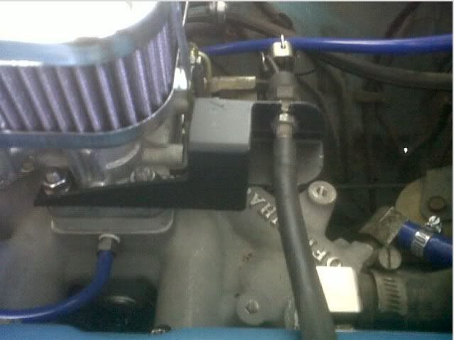

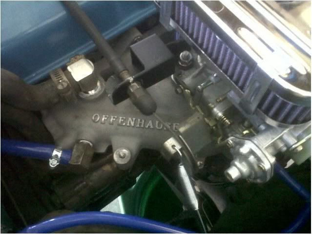

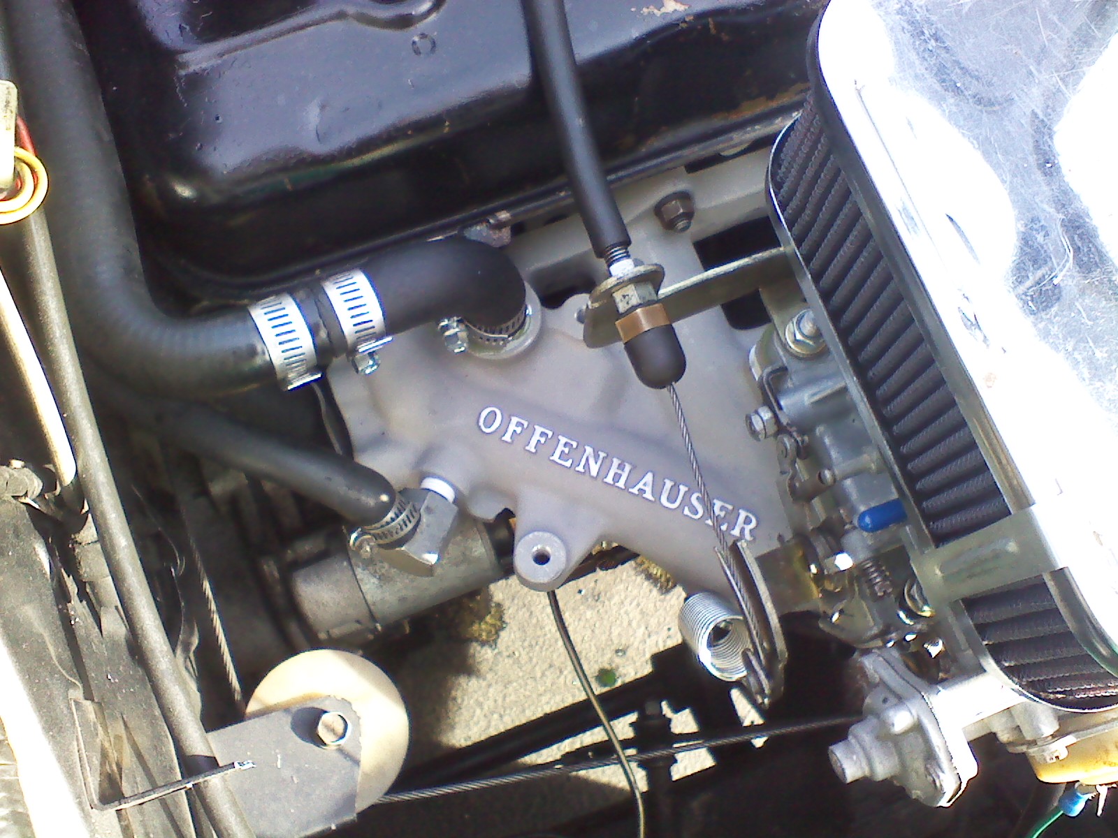

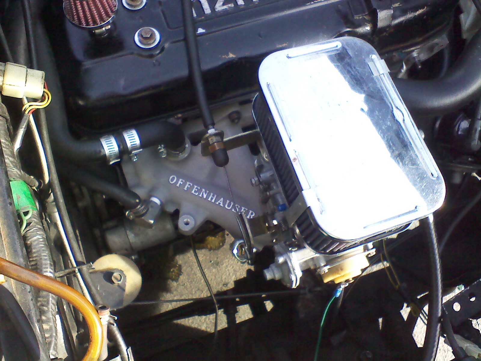

After 26 years hitachi carb finally died. I have a weber that was on a luv. I got a kit with adapter and gaskets with studs. no throttle cable adapter. Anyone have one or a good picture of how they made one. My parts package says weber on it but studs are a joke. Thry are undersize. I am going to play hell finding metric studs here but will keep looking.
So if anyone can help with cable adapter I would sure appreciate it.
I tried using different studs and the adapter plates bind. I ended up using the supplied studs.
Image There are plenty of examples here just a search button away on what people did to get their throttle brackets to work. This is what I did-

Thanks, I did mine as close to bolt in as possible and was how I remember we use to do it back in the 80's.
Here is what 1988Luv did, hope this helps-
viewtopic.php?f=6&t=15627

great pictures. Thanks a lot. Should be able to work from that.

Mine looks similar to that.
