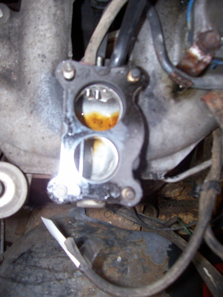

it rained one day, now it wont start. removed carb to rebuild and found this sitting in the intake manifold. Is this from rust in the lines/tank or from a dirty bad carb?

OR, it could be from the water that got in during the rain storm in your other post...

More than likely both!

I checked the fuel coming from the tank and pump and it seems clean, clean & without water seperation. Will do another seperation test. What way's could water get in? My gas cap was on tight and hood was in the closed position, but not locked.

I live in SD where the wind will blow rain in anywhere!I have seen it rain sideways because of the wind.
