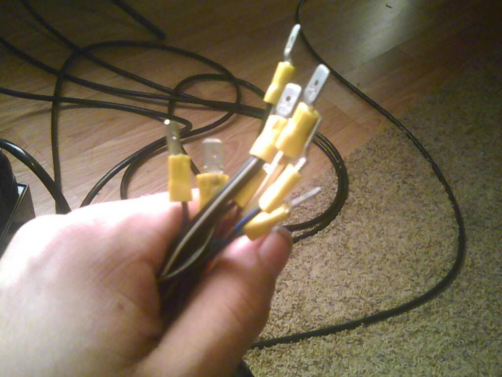

went to the local u-pull-it type yard and yanked a fusebox out of some other car :( sadly i do not remember what i yanked it out of. but it had the right types of connections for my fuse box which were
1 hot wire that powered 3 fuses
1 hot wire that powered 2 fuses
and 1 hot wire that only powered 1 hot wire.
even has some left over circuits so i can upgrade things later.
best thing of all, i didn't have to modify my existing wiring harness.
and i'm pretty sure(i'll find out tonight in the dark for sure) that this fixed my generator light being on faintly.
there's the fusebox
here's the connectors you need to hook it right up to your existing wiring harness
i had to cut off a little edge of the plastic on the fusebox to get it flush against the fender well, and drill a hole for the screw thru the fuse box as well. but there it is, mounted, and everything still works! the engine starts idles, can turn everything in the truck on and it stays running, and the generator light doesn't come on(at least noticably during the day)
