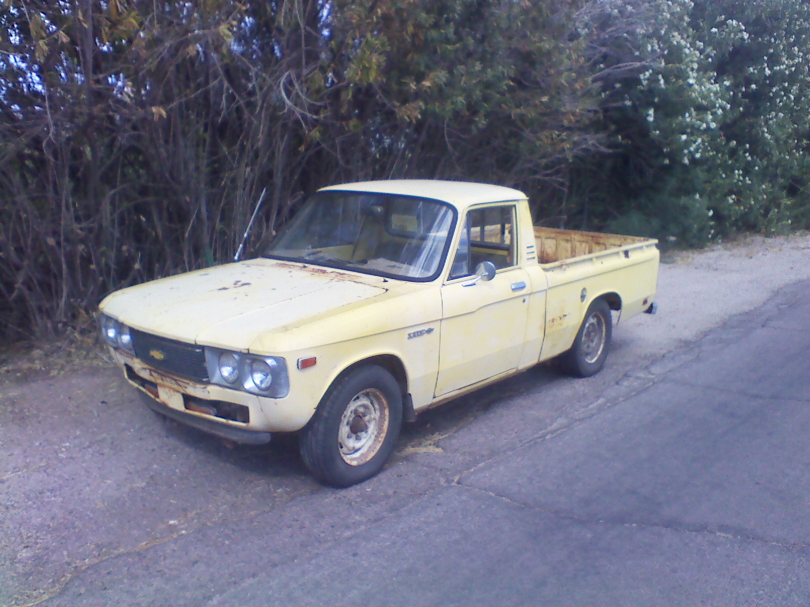

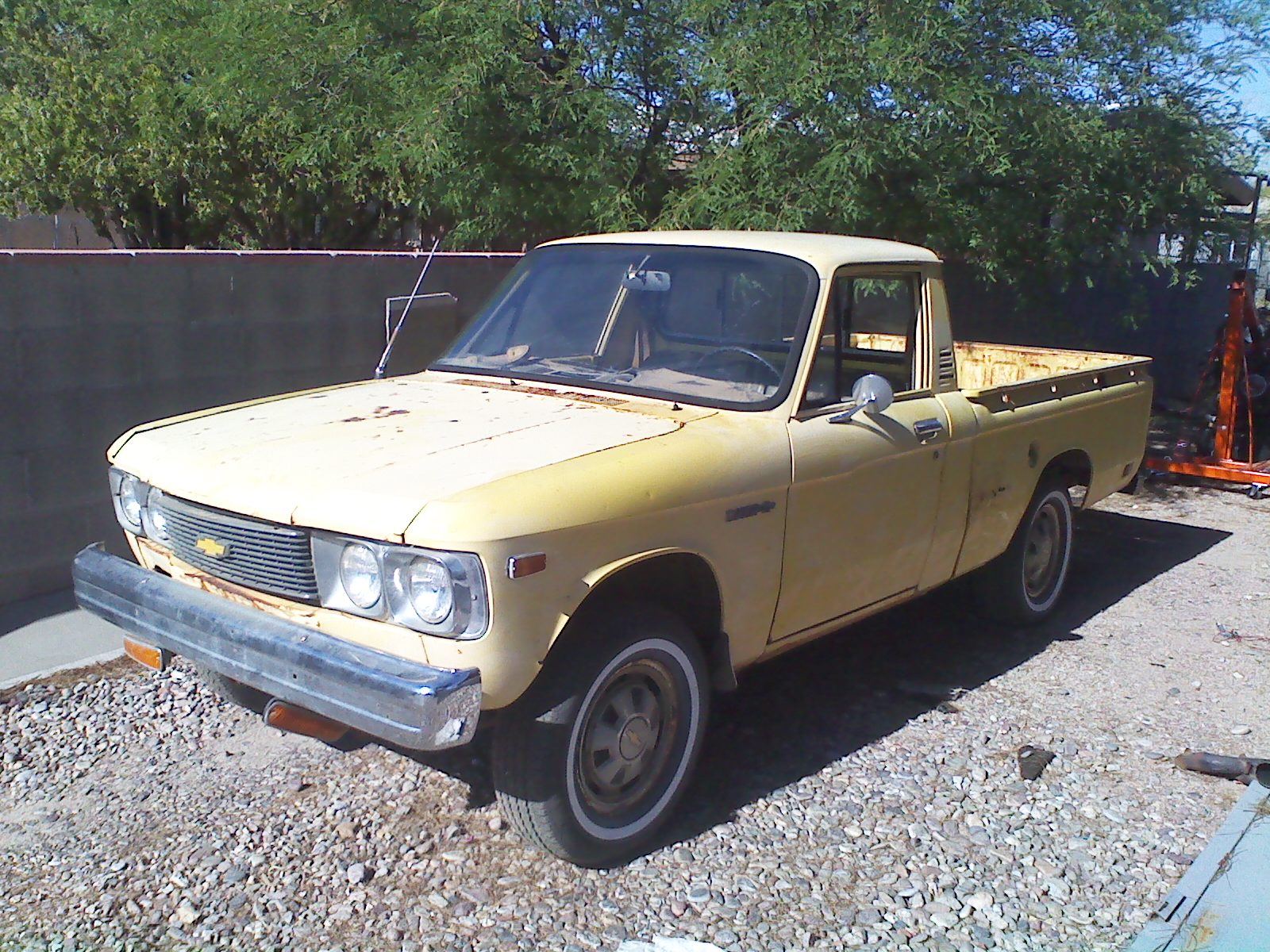

Here is the before and after:
File comment: how i got it
File comment: how it sits now
