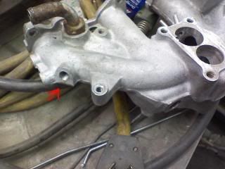

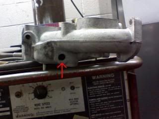

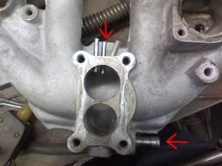

:econfused I started removing my smog stuff, and I forgot where somthings go, and what I dont need. so for starters
where do these go, or should I just cap them
then what about this one
and now this one
now I tried to use the manuel's but just wasnt computing in my brain. any help from any one would be great.
Top 3 ports left to right- Smog port, plug it, smog port, plug it also, and valve cover port, some type of PCV.
Bottom is smog and if you epoxy the intake you get rig of it and the EGR port in the bottom of the manifold. Don't see it but there should be another port next to it, and it goes to dist vacuum advance. See video for details on plugging EGR port inside intake manifold-
http://www.youtube.com/watch?v=o5f2DqrEQCc
Thats your port for power brakes
Quote:
and now this one
Water port to open EGR valve. Needs to be plug or you have a big water leak.

hey ethelkilledfred thanks alot that helps I did most of what you said, now I will watch that youtube video. but for the egr cover I just made a plate and but some gsket maker on it and bolted it down. the others I pluged, but the ones on the carb, just one. the other Its used for the vacume advance ( i think). and I was going the leave the small one on the valve cover that goes to the far right of the inside of the intake. there is one more that I wonder about but will post a pic of it when I get home its a ball shap that has a vacume that goes to the port that the booster is conceted to and then one line to inside of the cab, this sits on the driver front fender. I dont see it in any of my shop manuels but then again I dont have one for a 1979 luv. the 78 manuel dosent show it. so thanks.

No problem. If you plug the EGR port inside the manifold it plugs both vacuum ports, the big one the side of the manifold and the EGR port from underside of the manifold. Good luck
