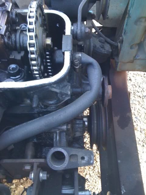

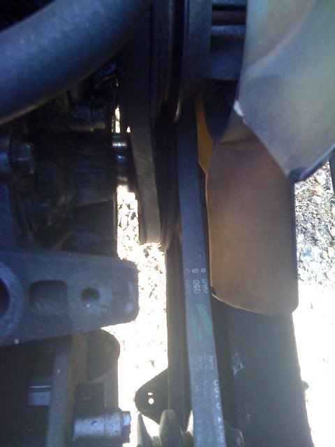

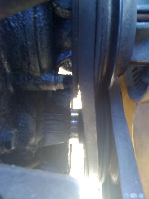

I started working on the LUV since it broke the oil pump and this is what I saw. The belts were miss aligned so I took a closer look and to my surprise I can see balancer sticking out ready to fall off.

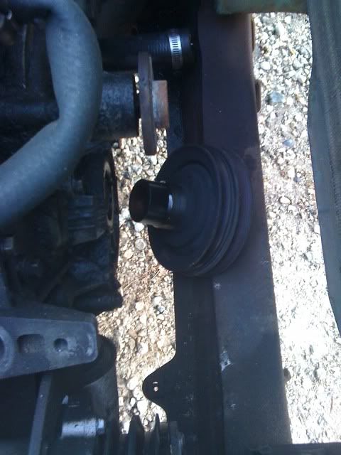

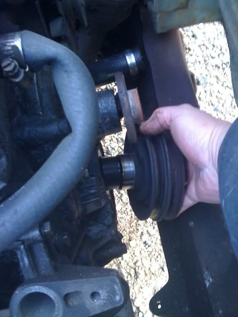

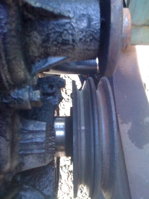

Balancer came out by hand. WOW, I got really luck it didn't come off while driving.

I agree. Surprisingly the bolt was still there, came out by hand also. A few more miles I don't think the bolt or the balancer would have been there.
