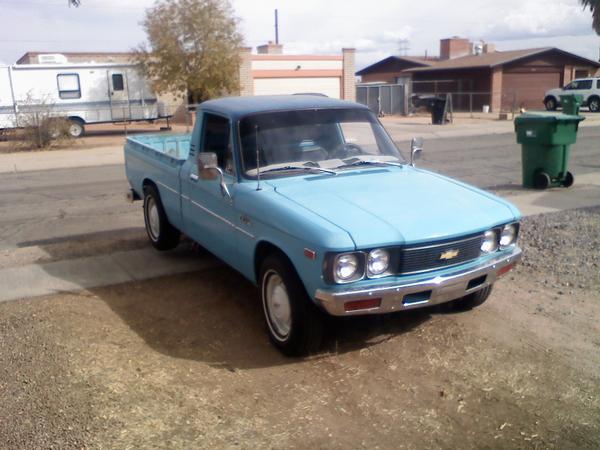

i do have some experience with motors just not carbureted motors. no i dont have big feet. yes it turns over. i havent had a chance to really look at it yet though to see if im getting power to the distributor or the spark plugs. so i gotta check into that first. if im getting spark im gonna to do some research on the type of carb i have and how everything works on carbs and all that good stuff. right now im stationed at ft. irwin, cali. thats like 40 minutes into the middle of the desert fom barstow. but like i said i know a little about engines. just barely enough to get me by but by no means am i an amazing mechanic. so i still have alot to learn about my little motor. oh and everthing is completely stock on it if i havent mentioned that so it is the stock carb. and this is what im working with.
stock '76 luv, work in progress

man ,that truck is clean!
