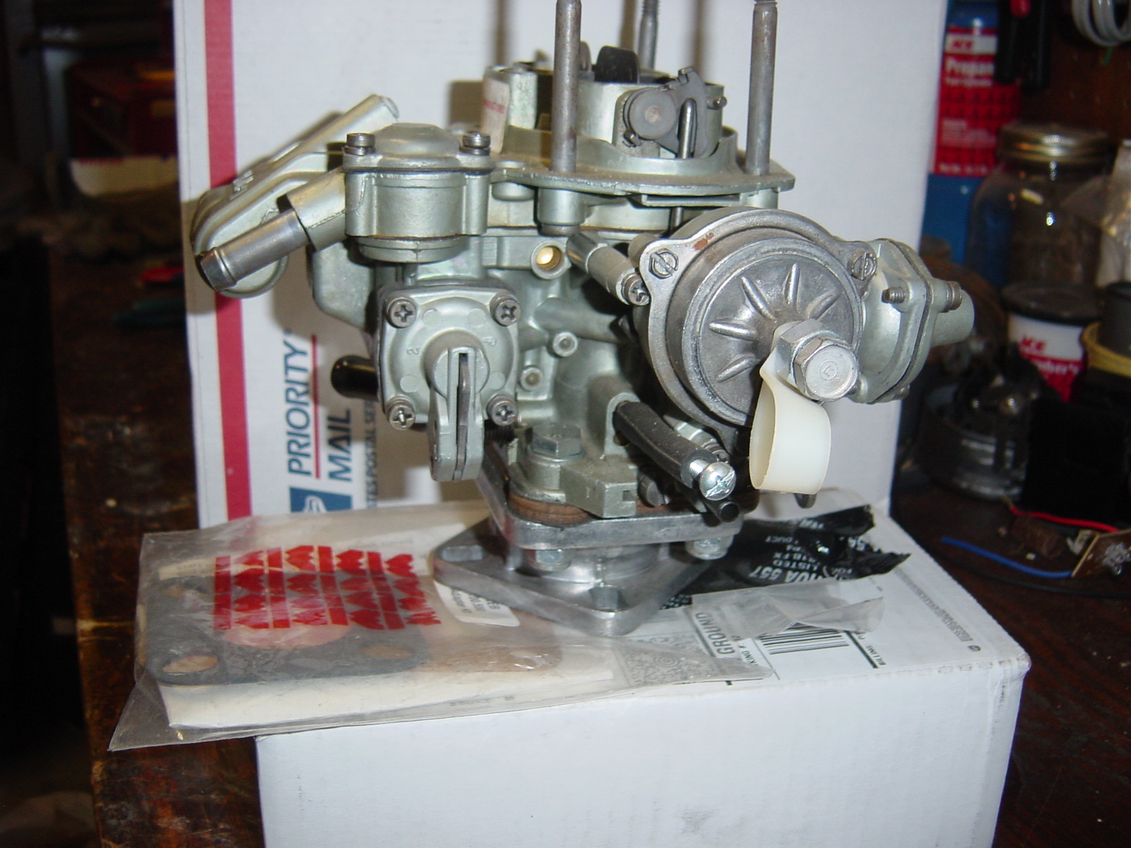

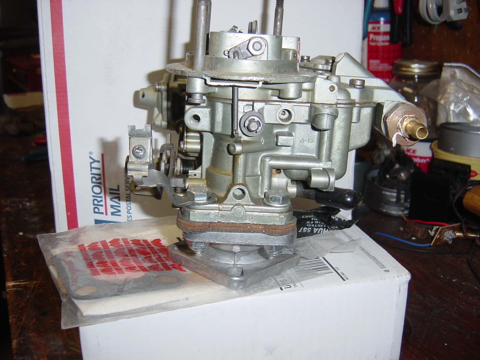

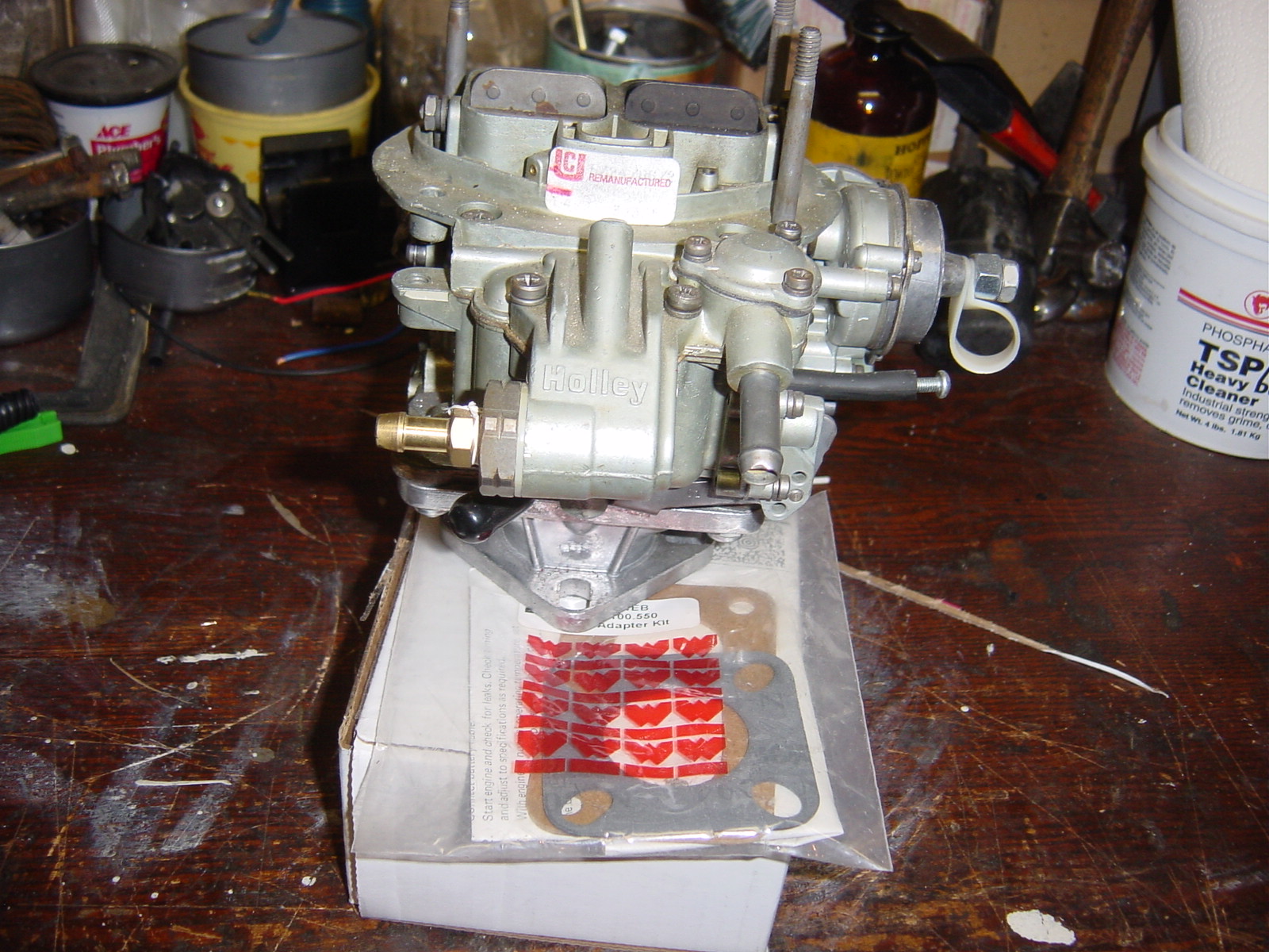

so i just got the vachum leak fixed but i turned the carb upside down to scrape the gasket and the slide out thing in the venture that lets the fuel out fell out into a big bucket of anti freeze. i found it cleaned it and reinstalled. problem is that it sits kinda loose and the other side appears to have a small shim of some kind between it and the venturi wall. all is well till i give the skinny pedle hell then it bogs. so i know it is leaking fuel. does any one know how to remidy this or where to buy a new one. the other option is this weber available to me for 100bucks factory rebuilt. is this the one ideal for the luvs. he said it was a 32 36 but i know there was other variables. thanks

That's a 32/36 DFEV (Same as the Holley 5200), it's a mirror image of the Weber 32/36 DGEV, and I think you'll have to work harder to bolt that one on. Means the primary and secondary are opposite and so I think the fuel line and accelerator linkage will come out in the wrong spot. Ideally you want the DGEV.
